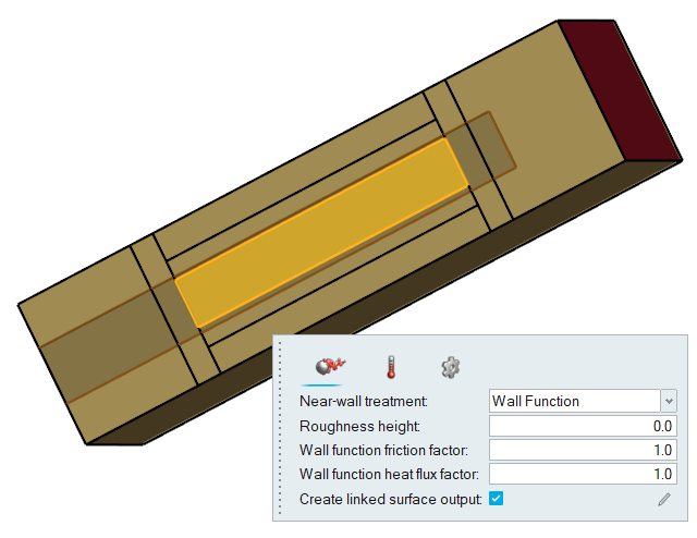

The problem to be addressed in this tutorial is shown schematically in Figure 1. It consists of a channel with a heated wall at the bottom. The temperature of the wall is selected to onset the nucleate boiling at the heated wall.

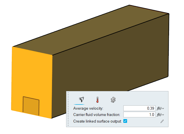

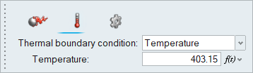

Water at 2 bar pressure and 95 ℃ temperature enters the inlet at an average velocity of 0.39 m/sec and passes through the heated wall which is maintained at 130 ℃.

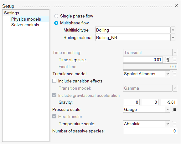

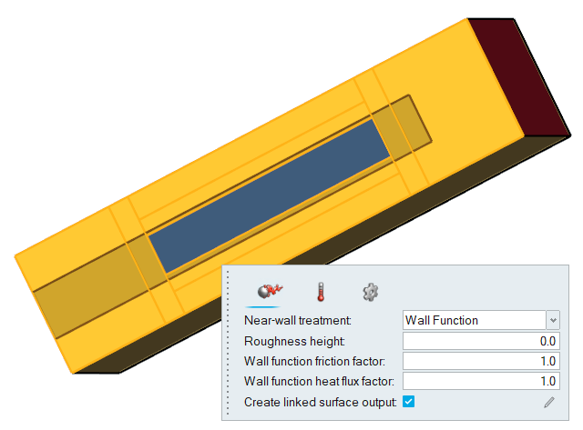

Set Up Flow

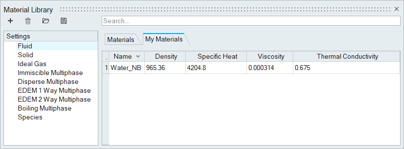

Verify and Create Materials
Assign Material Properties

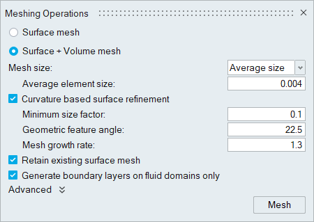

Generate the Mesh

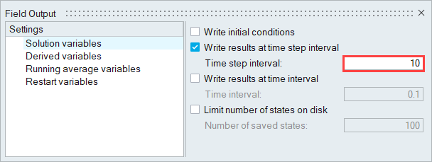

Run AcuSolve

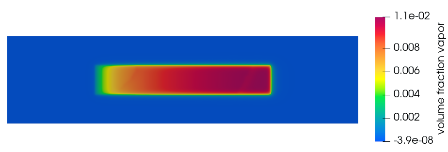

Post-Process the Results with HW-CFD Post
Summary
