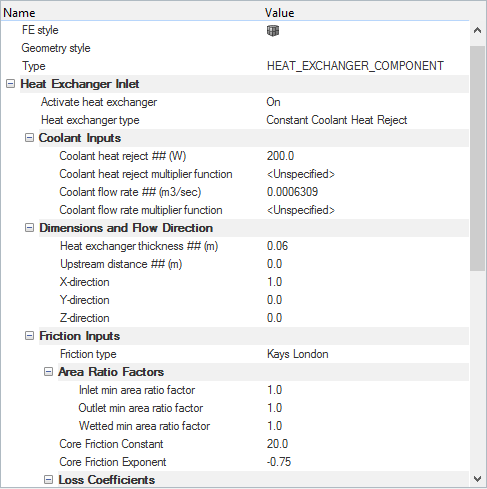

The problem to be addressed in this tutorial is shown schematically in the figure below. It consists of a cylindrical pipe channel with an interior heat exchanger component volume with thickness ‘t’ and radius ‘r’. The heat exchanger component parameters are assigned to the HEX_Inlet surface component. Basically, the heat exchanger model is applied to a surface and the temperature rises across that surface to model the effect of the heat exchanger. Air enters the pipe at a velocity of 0.1 m/sec and flows through the heat exchanger volume and then exits through the outlet.

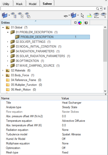

In this step, you will set the simulation parameters that apply globally to the simulation.

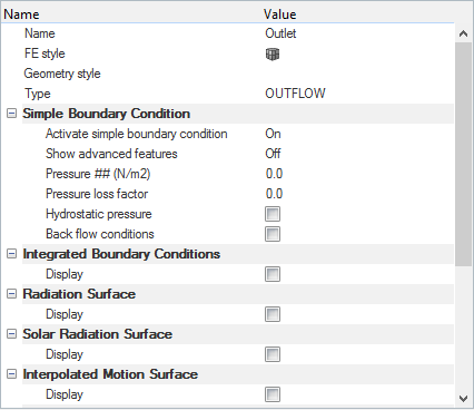

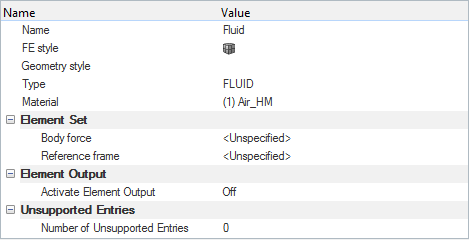

Set Up Boundary Conditions and Assign Material Model Parameters

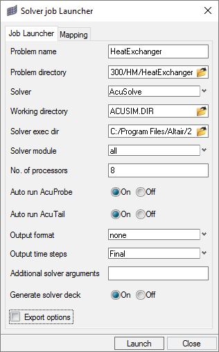

In this step, you will launch AcuSolve directly from HyperMesh and compute the solution.
Run AcuSolve

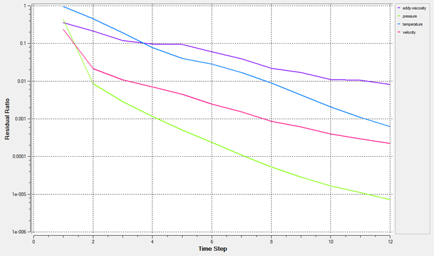

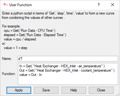

As the solution progresses, the AcuTail and AcuProbe windows are launched automatically. The surface output and residual ratios can be monitored using AcuProbe.

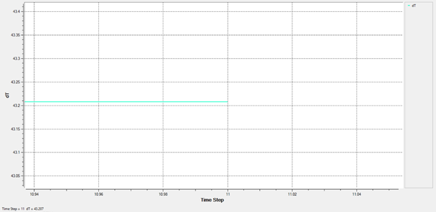

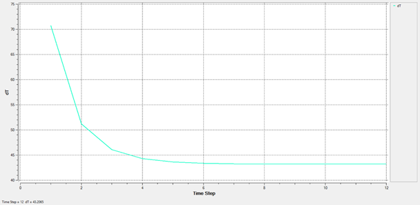

Summary
