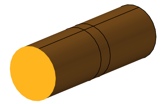

Validate the Geometry
Figure 3.

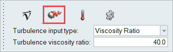

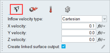

Set Up Flow

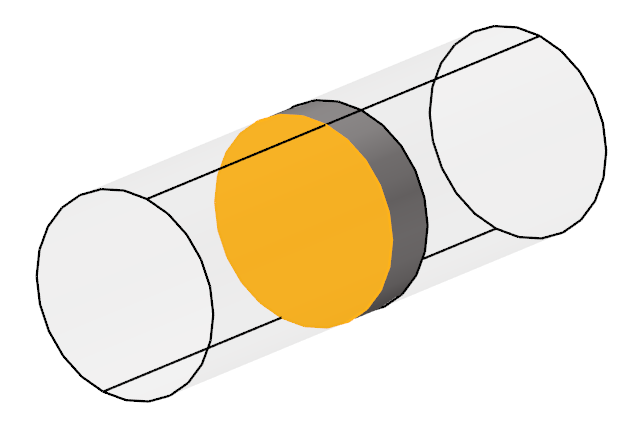

Define the Heat Exchanger Component

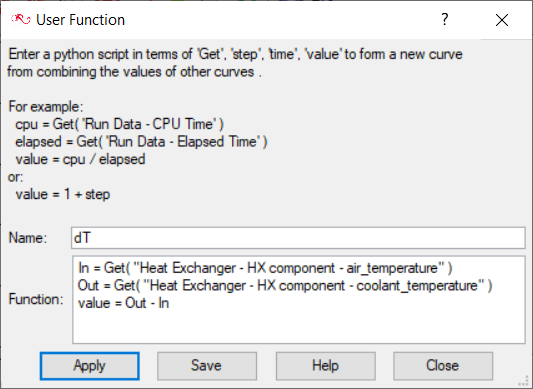

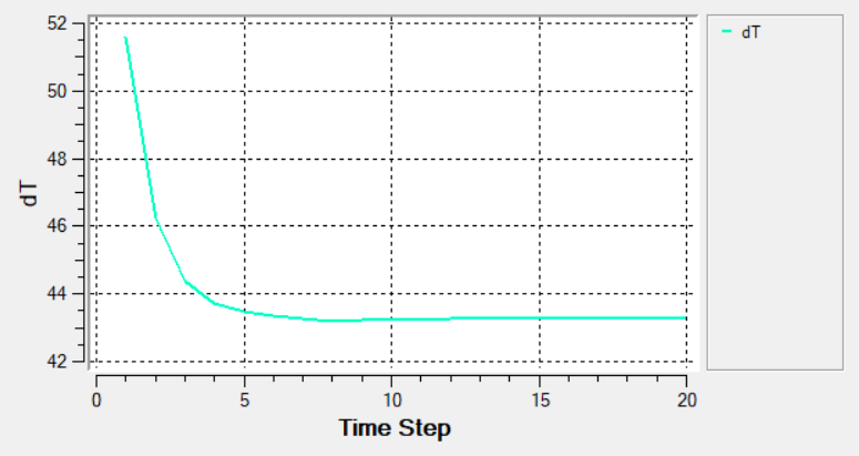

Post-Process with AcuProbe

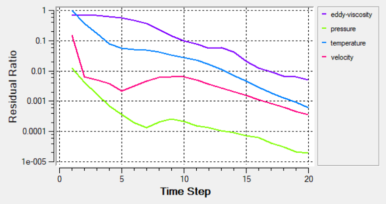

As the solution progresses, the AcuTail and AcuProbe windows are launched automatically. The surface output and residual ratios can be monitored using AcuProbe.
Summary
In this tutorial, you successfully learned how to set up and solve a simulation involving a Heat Exchanger component using HyperWorks CFD. You started by opening the HyperMesh input file with the geometry and then defined the simulation parameters, the heat exchanger component, and the flow boundary conditions. Once the solution was computed, you defined a user-function in AcuProbe in order to create a plot of the temperature rise across the heat exchanger volume.
