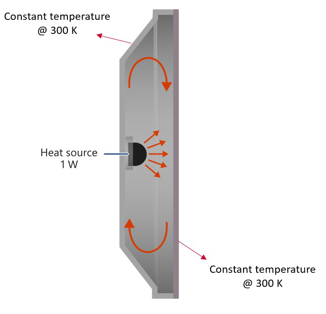

Problem Description

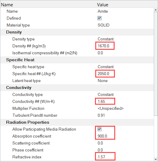

| Absorption Coefficient | Refractive Index | |
| Air | 0 | 1.0 |
| Lens | 900 | 1.57 |

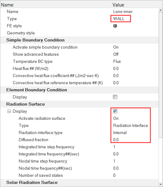

| Surface Type | Radiation Surface Type |
| Participating medium - Participating medium Interface | Radiation Interface - Internal |
| Participating medium - (Non- Participating) medium Interface | Wall |
| External boundaries of Participating medium | Radiation Interface - External or Wall |
Figure 3.

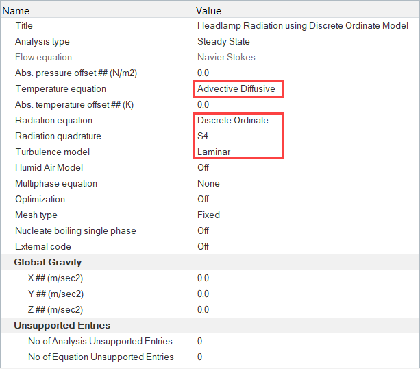

Set the Analysis Parameters

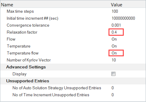

Specify the Solver Settings

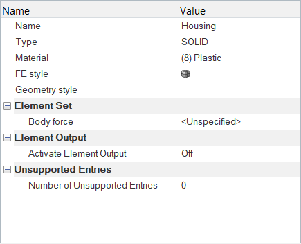

Define the Material Models and the Body Force

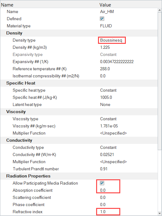

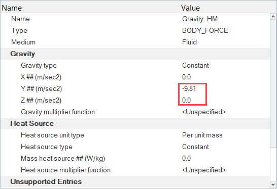

Define the Body Force

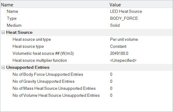

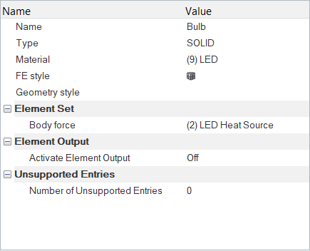

Define the Heat Source

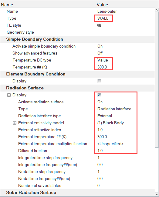

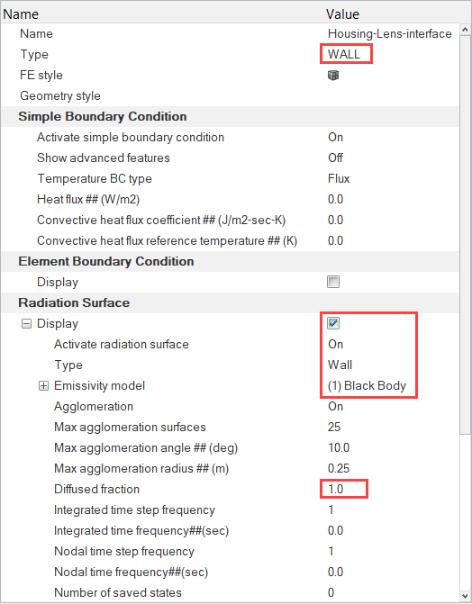

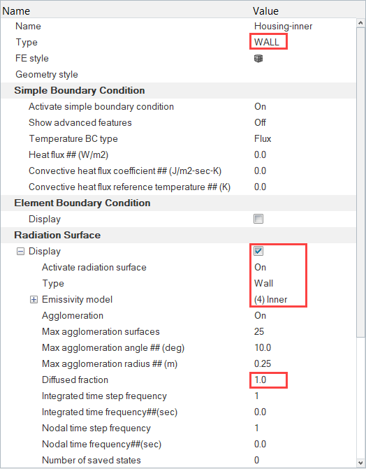

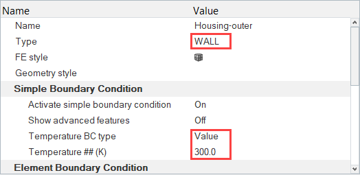

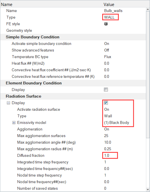

Set the Boundary Conditions

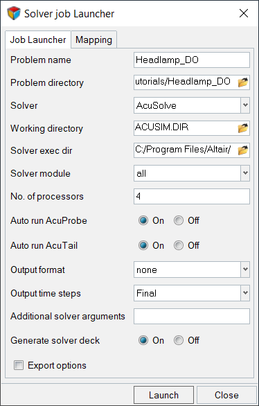

Run AcuSolve
In this step, you will launch AcuSolve to compute a solution for this case.

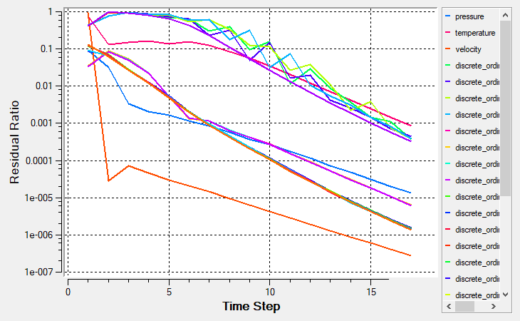

While AcuSolve is running, you can monitor the progress of the solution using AcuProbe and plot the values of residual ratios, solution ratios, and variables like temperature, heat flux, etc. Once the solver run has started, the AcuTail and AcuProbe windows should be launched automatically.

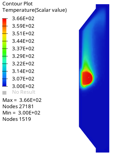

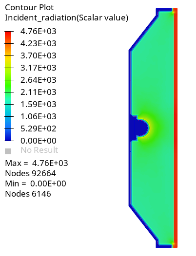

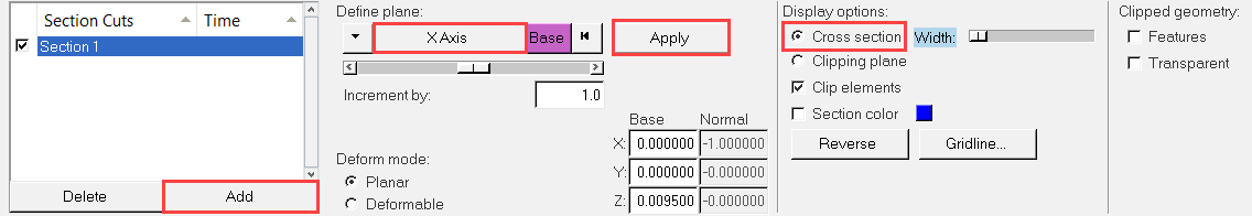

Create Temperature and Incident Radiation Contours on a Section Cut

In this tutorial, you learned how to set up and solve a radiation heat transfer problem in a headlamp using the discrete ordinate radiation model in AcuSolve. You started by importing the HyperMesh database with the mesh and basic model organization, and then set up the simulation parameters and boundary conditions. Once the solution was computed, you processed the results using HyperView, where you created contour plots of temperature and incident radiation.
