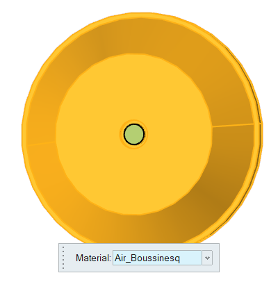

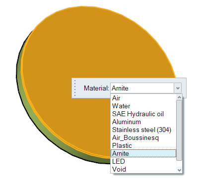

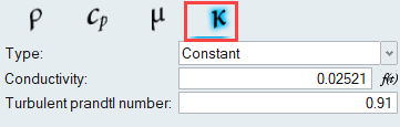

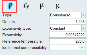

Define the Material Models
Assign Material Properties

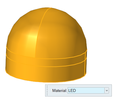

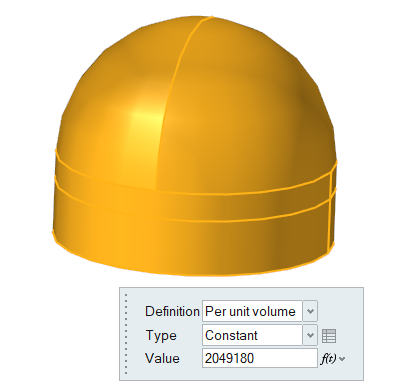

Define the Heat Source

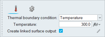

In this problem, all the surfaces are walls and will therefore be assigned the default wall boundary condition. The outer walls of the headlamp will be given a no-slip wall boundary condition with a constant temperature.

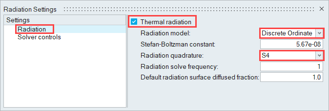

Set Up Radiation
In this step, you will specify the parameters related to the thermal radiation setup.
Define Radiation Model Settings

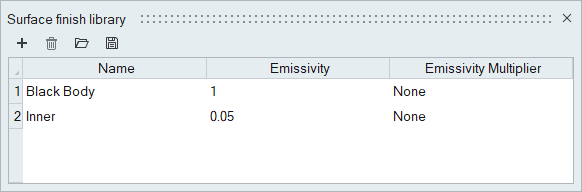

Define the Emissivity Models

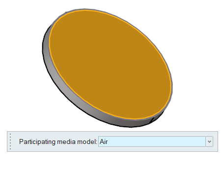

Define the Participating Media Radiation Models
Assign Participating Media Models

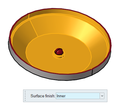

Assign Surface Finish Models

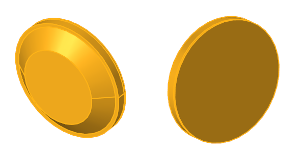

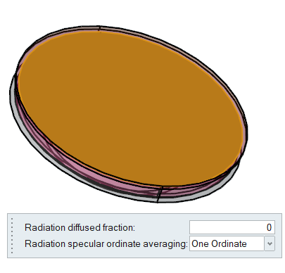

Define the Radiation Interfaces
Since the lens and air are defined as semi-transparent media, the interface between the two will be modeled as a specular interface of type: internal. Accordingly, the outer surfaces of the lens will be modeled as external interface radiation surface.

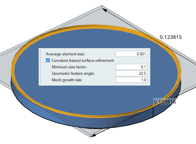

Define the Surface Mesh Controls

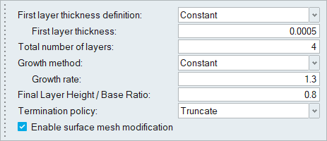

Define the Boundary Layer Controls

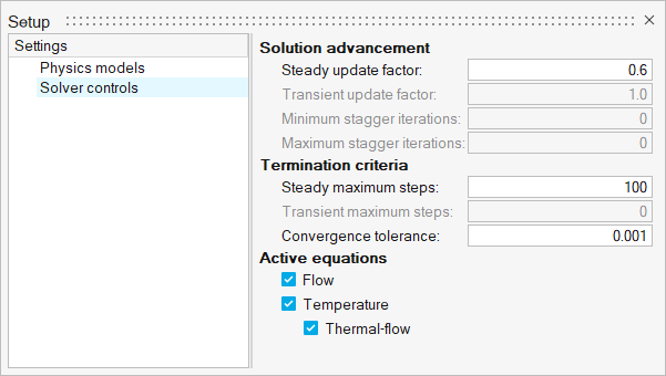

Run AcuSolve

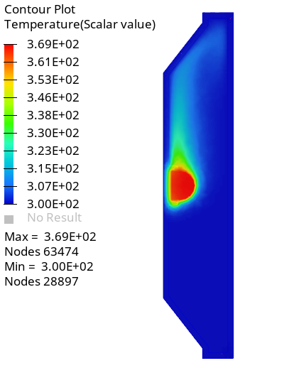

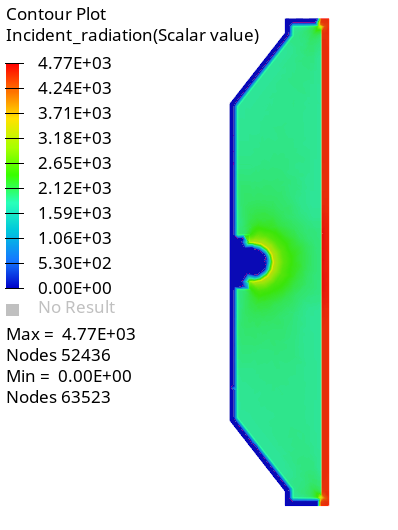

Create Temperature and Incident Radiation Contours on a Section Cut
Summary
In this tutorial, you learned how to set up and solve a radiation heat transfer problem in a headlamp using the discrete ordinate radiation model in HyperWorks CFD. You started by importing and cleaning up the geometry and then set up the flow, thermal, and radiation boundary conditions. Once the solution was computed, you processed the results using HyperView, where you created contour plots of temperature and incident radiation.
