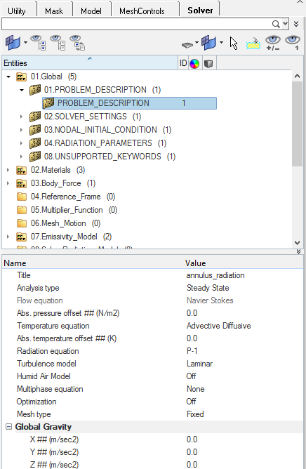

Set Up Radiation Parameters and Boundary Conditions

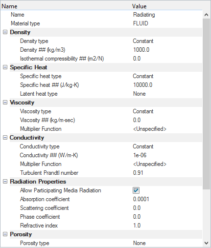

In this step, you will define the radiation parameters i.e. emissivity models, surface boundary conditions for the problem, and assign material properties to the fluid and solid regions.
Set Up Material Model Parameters

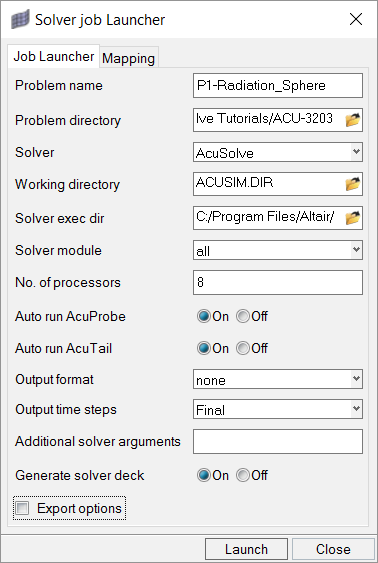

In this step, you will launch AcuSolve directly from HyperMesh and compute the solution.
Run AcuSolve

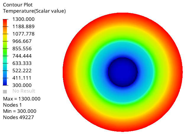

Create Temperature Contours
In this step, you will create a contour plot of temperature distribution across the domain.
