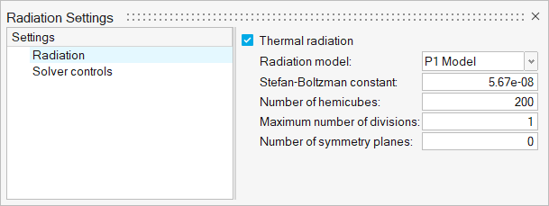

Set Up Radiation
Select the Radiation Model
Define the Radiation Material Properties
Assign the Participating Media Model
Assign the Emissivity Model

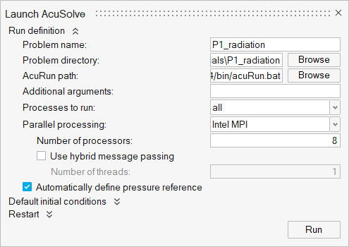

Run AcuSolve

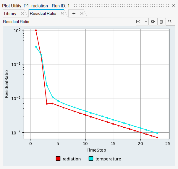

In this tutorial, you learned how to set up and solve a radiation heat transfer simulation using the P1 radiation model. You started by importing the HyperWorks CFD input database and defining the flow and radiation setup. Then, you generated the mesh and submitted the AcuSolve simulation. Once the solution was computed, you created a plot of residual ratios using the plot utility in HyperWorks CFD. Finally, you created a contour plot of temperature distribution on a section cut using HyperWorks CFD Post.
