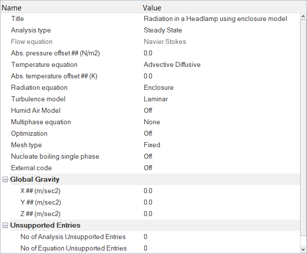

Set the Analysis Parameters

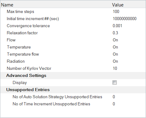

Specify the Solver Settings

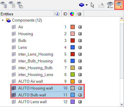

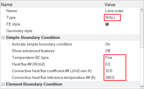

Set the Boundary Conditions

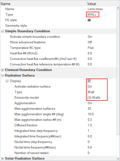

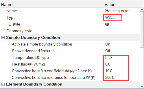

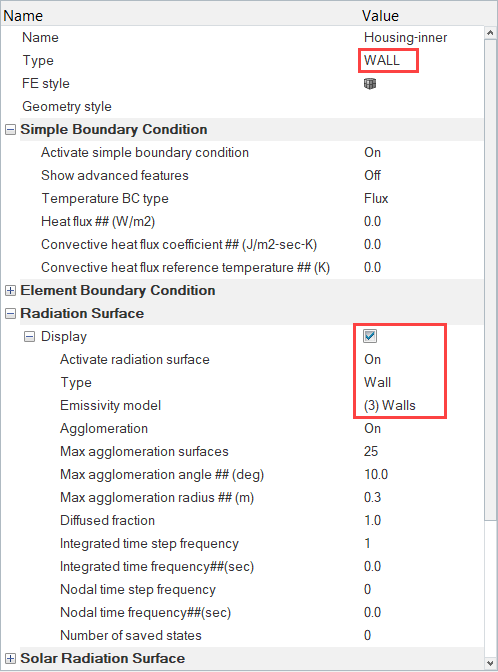

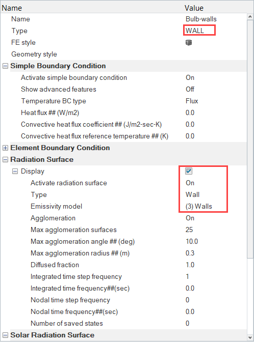

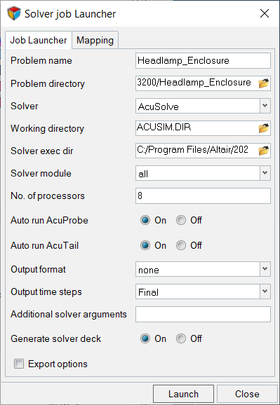

Run AcuSolve
In this step, you will launch AcuSolve to compute a solution for this case.

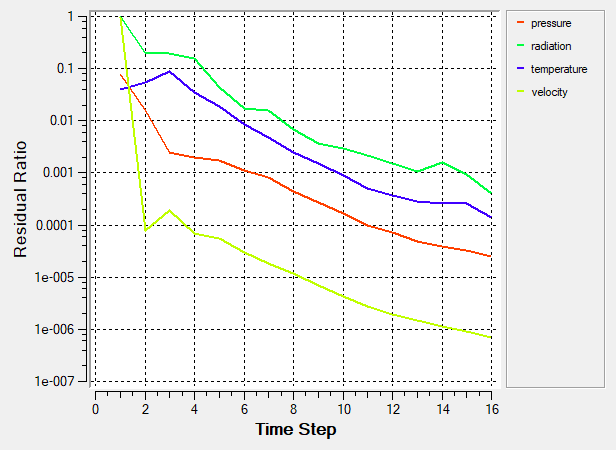

Monitor the Solution with AcuProbe
While AcuSolve is running, you can monitor the progress of the solution using AcuProbe and plot the values of residual ratios, solution ratios, and variables like temperature, heat flux, etc. Once the solver run has started, the AcuTail and AcuProbe windows should be launched automatically.

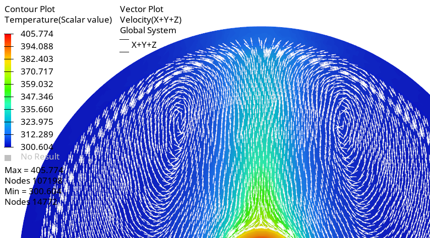

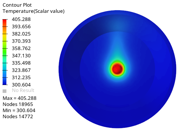

Create a Contour Plot of Temperature

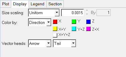

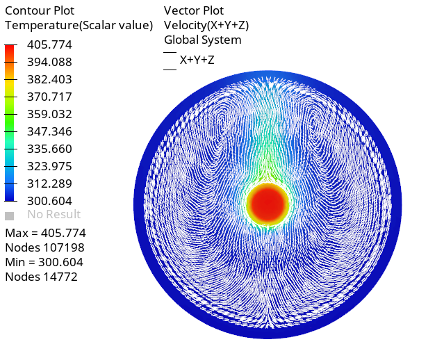

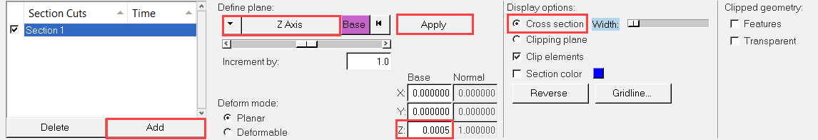

Display Temperature Contours and Velocity Vectors on a Section Cut
In this step, you will create a section cut on the mid-z plane and then display the temperature and velocity vectors on that cross section.
