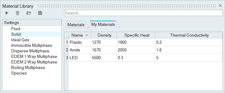

Define the Material Models
Assign Material Properties

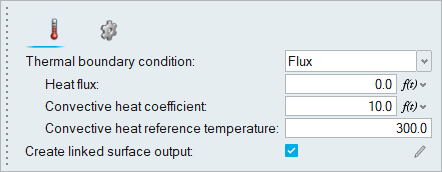

In this problem, all the surfaces are walls and will therefore be assigned the default wall boundary condition. The outer walls of the headlamp will be given a no-slip wall boundary condition with a convective heat flux boundary condition.

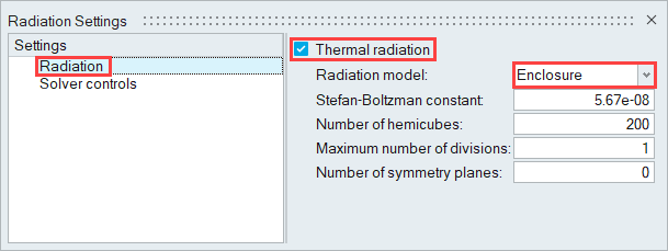

In this step, you will specify the parameters related to the thermal radiation setup.
Define Radiation Model Settings

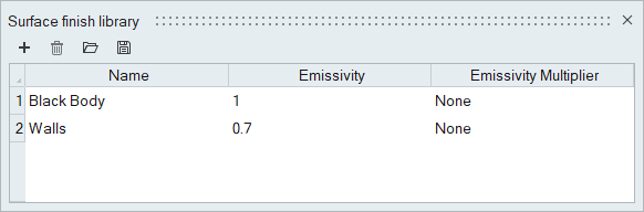

Define the Emissivity Models

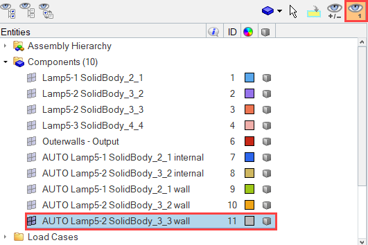

Assign Surface Finish Models

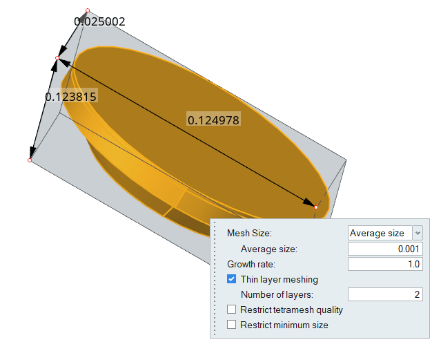

Define the Volume Mesh Controls
Since the thickness of the housing and the lens solids are small, you will use the thin layer meshing tool so that when the volume mesh is generated, there will be two layers across the thickness of those solids.

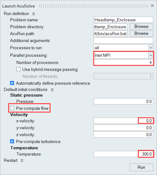

Run AcuSolve

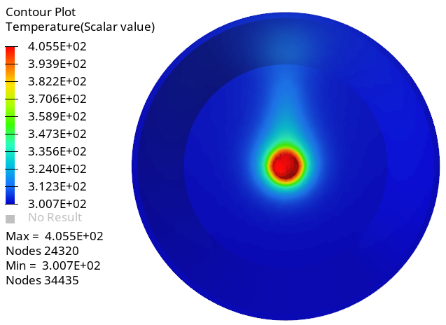

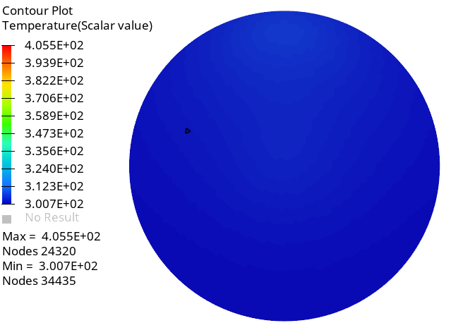

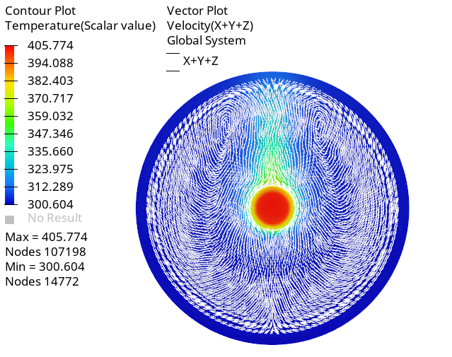

Create a Contour Plot of Temperature
Display Temperature Contours and Velocity Vectors on a Section Cut
In this step, you will create a section cut on the mid-z plane and then display the temperature and velocity vectors on that cross section.
