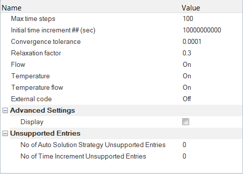

Specify the Solver Settings

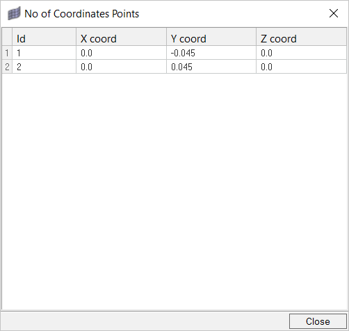

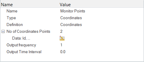

Create Time History Output Points
The Time History Output command enables you to extract the nodal solution at any point within the domain.

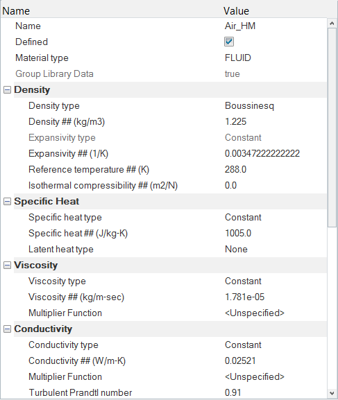

Modify the Material Model Parameters of Air

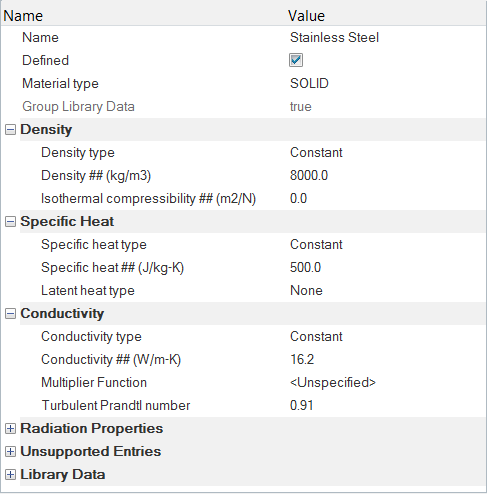

Create a Material Model for the Solid

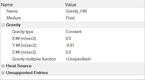

Define the Gravitational Body Force

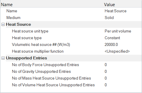

Define the Volumetric Heat Source

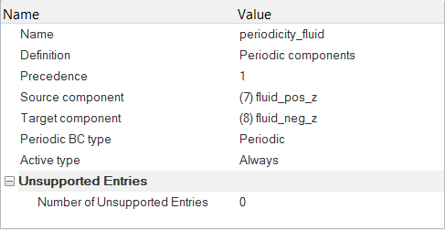

Specify the Periodic Boundary Conditions
Since you are modeling only a portion of the infinitely long domain, you need to define the periodicity of the solution by specifying periodic boundary conditions. The solution is then constrained by periodicity. The periodic boundary condition links the corresponding pairs of nodes on the two surfaces on which the periodicity is defined.

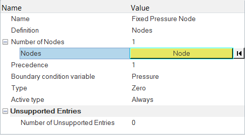

Specify the Reference Pressure
Since this model set up doesn’t have an inlet and outlet, we need to specify the reference pressure manually. This can be done by specifying a pressure nodal boundary condition at a node in the fluid region.

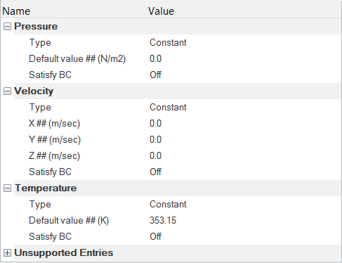

Specify the Nodal Initial Conditions

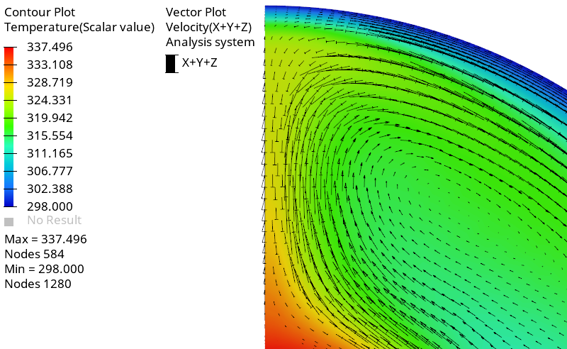

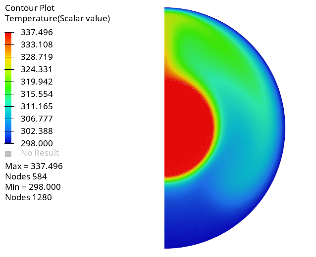

Create a Temperature Distribution Contour

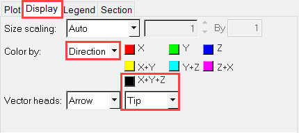

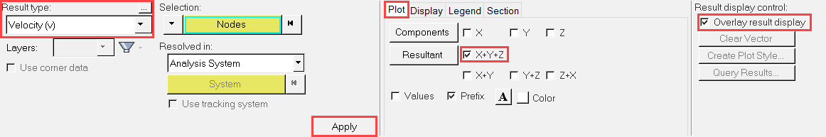

Create a Velocity Vector Plot
Summary
In this tutorial, you successfully learned how to set up and solve a natural convection problem using AcuSolve in HyperMesh. You started by importing the HyperMesh model database and then set up the simulation parameters and boundary conditions. Once the solution was computed, you post-processed the results using HyperView and created a contour plot of temperature distribution across the domain.
