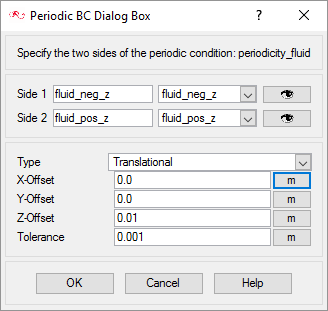

- Set up periodic boundary conditions

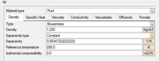

- Create a new custom material model in AcuConsole and assign material properties to it

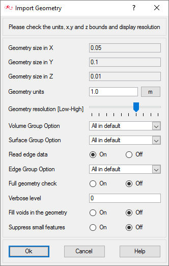

- Import the geometry for the simulation

- Set periodic boundary conditions

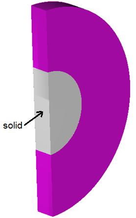

The system being simulated contains an internally-heated cylinder, which is surrounded by a cylindrical ring of a larger diameter. The annular volume between the two cylinders is filled with a fluid (air). The inner cylinder thus acts a heat source, and the fluid in contact with the surface of this heat source is heated up. This hot fluid, being lower in density than the cold fluid, then rises up to the upper part of the annulus due to buoyancy effects, and displaces the cold fluid at top. At the same time, the film of fluid which was in contact with the heating surface is replaced by the surrounding cold fluid. This new film of cold fluid goes through the same process until eventually a steady state convection current is achieved, or the inner cylinder ceases to generate heat and slowly the whole system achieves an equal temperature.
The system being simulated can be considered similar to a heat exchanger wherein the inner cylinder is akin to a tube through which a hot fluid passes by, and the air which surrounds this inner tube extracts heat from the inner tube. Another analogy can be of a wire carrying high current enclosed in an air cooled chamber. As the current heats up the wire due to resistance, the air around the wire keeps the wire temperature within control by extracting heat from the wire surface.

The Boussinesq density model is an approximation method applied to buoyancy driven flows, such as natural convection flows. In the Boussinesq approximation, the density variation terms are neglected everywhere except when multiplied by acceleration due to gravity, . The basis of this approximation is that since temperature changes are small, the resultant changes in density are small as well and thus can be neglected. However, when multiplied by , the resultant term gives rise to forces which no longer are negligible. The Boussinesq approximation is:
- is the instantaneous density at temperature (kg/m3)
- is the density at reference temperature (kg/m3)
- is change in temperature (K)
As stated in the approximation, the Boussinesq density model is only applicable when density variations are small. A general guideline is to check for the condition to be true. This indirectly puts a limitation on this model to be used to only for cases where expected temperature differences within the fluid are not large.

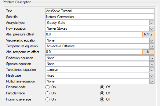

Set General Simulation Parameters
In next steps you will set parameters that apply globally to the simulation. To make this simple, the basic settings applicable for any simulation can be filtered using the BAS filter in the Data Tree Manager. This filter enables display of only a small subset of the available items in the data tree and makes navigation of the entries easier.

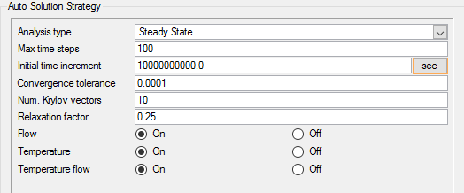

Set Solution Strategy Parameters
In the next steps you will set the parameters that control the behavior of AcuSolve as it progresses during the solution.

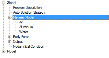

Set Material Model Parameters

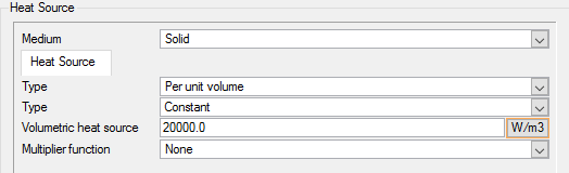

The second body force which will be used in this model is the volumetric heat source, which specifies the heat energy source term per unit volume. This will be used to simulate the heat-generating inner cylinder in our model.

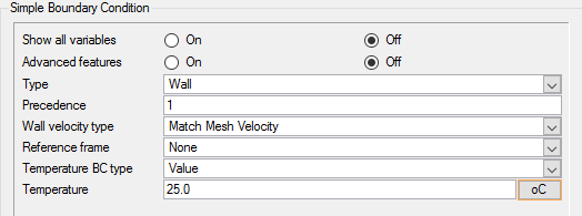

In the next steps you will define surface groups, assign the appropriate settings for the different characteristics of the problem, and add surfaces to the group containers.
In the process of setting up a simulation, you need to move into different panels for setting up the boundary conditions, mesh parameters, and so on, which can sometimes be cumbersome, especially for models with too many surfaces. To make it easier, less error prone, and to save time, two new dialogs are provided in AcuConsole. Use the Volume Manager and Surface Manager to verify and provide the information for all surface or volume entities at once. In this section some features of Surface Manager are exploited.

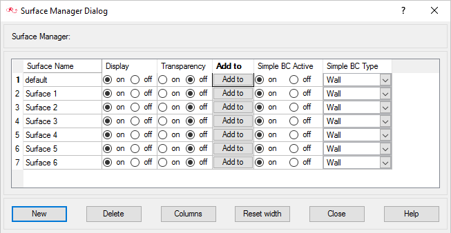

When the geometry was loaded into AcuConsole, all geometry surfaces were placed in the default surface group container. This default surface group was renamed to inner_walls. In the previous steps, you assigned some surfaces to various other surface groups that you created. At this point, all that is left in the inner_walls surface group are the surfaces which make up the contact boundary between the inner cylinder and the fluid volume.
Assign Surface Parameters

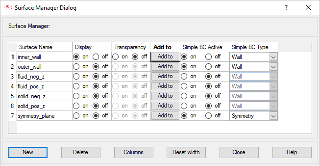

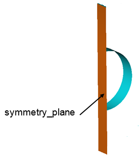

The modeling for this simulation was done using half symmetry. The model is only a partial representation of the system, the complete geometry of which is a cylinder. Hence it is appropriate to set the surface that you chose as symmetry_plane with a symmetry boundary condition to simulate that effect.
This change was completed using the Surface Manager in the last section. The following steps are thus optional.

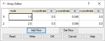

Create Time History Output Points
Time History Output commands enables you to extract the nodal solution at any point within the domain.

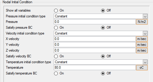

Set the Initial Conditions

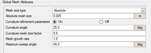

Set Global Mesh Parameters
Now that the flow characteristics have been set for the whole problem, a sufficiently refined mesh has to be generated.
Global mesh attributes are the meshing parameters applied to the model as a whole without reference to a specific geometric volume, surface, edge, or point. Local mesh attributes are used to create mesh generation controls for specific geometry components of the model.
In the next steps you will set the global mesh attributes.

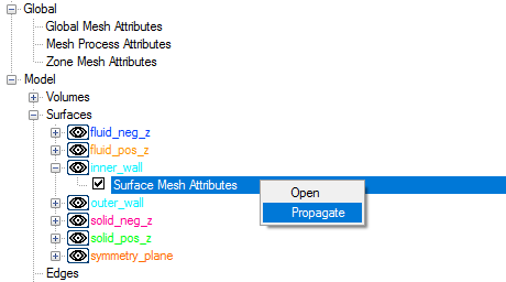

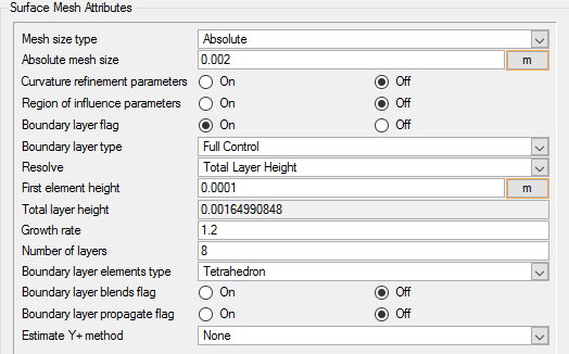

Set Surface Mesh Parameters
Surface mesh attributes are applied to a specific surface in the model. It is a type of local meshing parameter used to create targeted mesh controls for one or more specific surfaces.
Setting local mesh attributes, such as surface mesh attributes, is not mandatory. When a local mesh attribute is not found for a component, the global attributes are used as the mesh generation control for that component. If a local mesh attribute is present, it will take precedence over the global setting.
In the next steps you will set the surface meshing attributes.

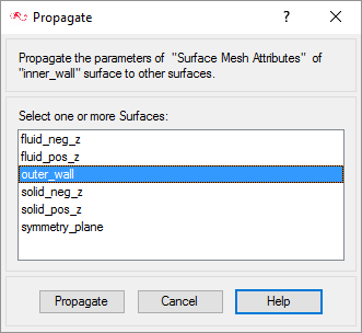

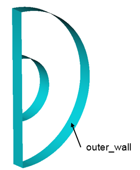

Instead of repeating the above steps for the outer_wall surface, you can choose to propagate the mesh attribute settings for inner_wall surface group to outer_wall surface group.

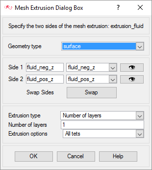

Define Mesh Extrusion
The present simulation is equivalent to a 2D representation of the model, which actually extends infinitely in both sides along the z-direction. In AcuSolve, 2D models are simulated by having just one element across the faces of the cross section. Thus when these faces are set up with a similar boundary condition, it coerces the corresponding nodes across the faces to have same results. In this problem, these faces are the negative and positive z-surfaces. This kind of mesh is achieved in AcuSolve with mesh extrusion process. In the following steps, the process of extrusion of the mesh between these surfaces is defined.

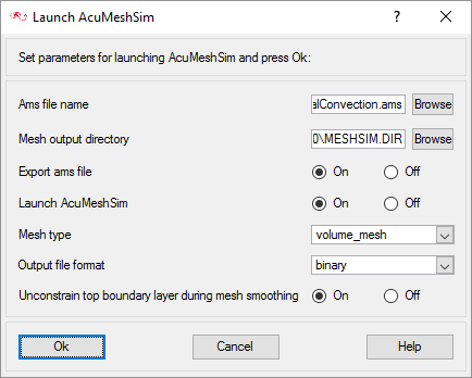

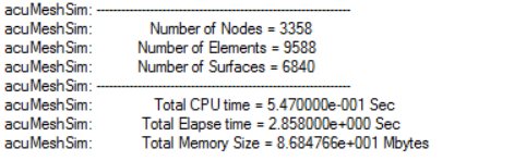

Generate the Mesh
In the next steps you will generate the mesh that will be used when computing a solution for the problem.

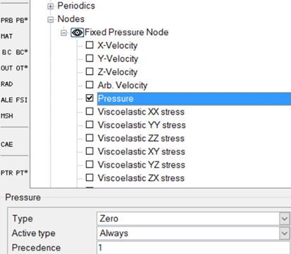

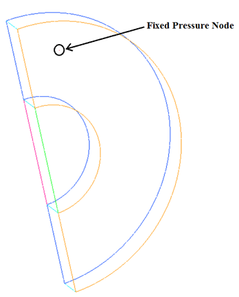

Assign Reference Pressure
The present case does not have any inlet or outlet surfaces to define any boundary condition that sets the pressure level inside the domain. To make the solution more robust, you will set a pressure reference point using a nodal boundary condition. The following steps will show how to setup the reference pressure inside the CFD domain.

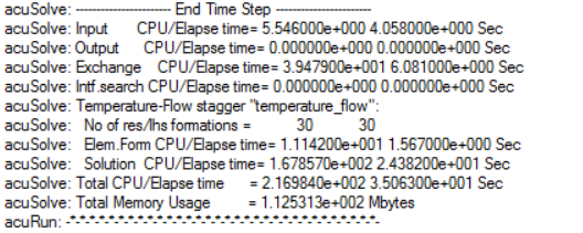

Run AcuSolve
In the next steps you will launch AcuSolve to compute the solution for this case.

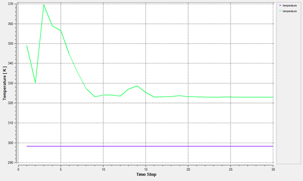

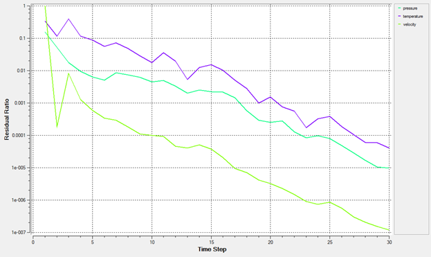

Post-Process with AcuProbe
AcuProbe can be used to monitor various variables over solution time.

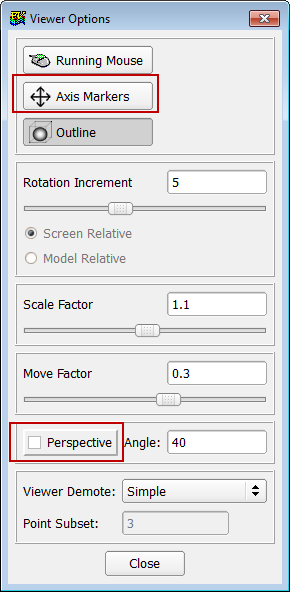

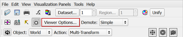

Manipulate the Model View in AcuFieldView

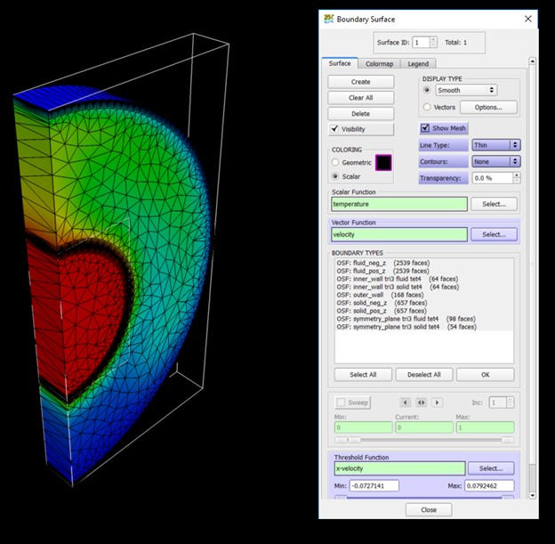

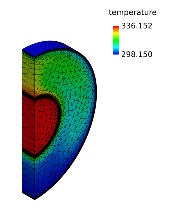

Create the Boundary Surface Showing Temperature for the Outer Surfaces with Mesh

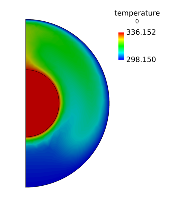

Coordinate the Surface Showing Temperature on the Mid-Coordinate Surface
Coordinate the Surface Showing Vectors of Velocity on the Mid-Coordinate Surface

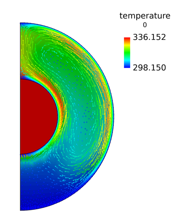

In this AcuSolve tutorial, you successfully set up and solved a natural convection problem. The problem simulated a hot cylinder placed in the center of another air-filled cylindrical volume. Air was modeled using a Boussinesq density approximation model, which is used for buoyancy driven flows, such as those involving natural convection. As the film of air in vicinity of the surface of the hot inner cylinder heated up, it generated convection currents within the annular volume.
You started the tutorial by creating a database in AcuConsole, importing and meshing the geometry and setting up the basic simulation parameters. The hot inner cylinder was represented by a solid volume also acting as a heat source. Once the case was setup, the solution was generated with AcuSolve.
Results were post-processed in AcuFieldView where you generated a temperature profile, and a velocity vector profile, on a cross-section of the model.
