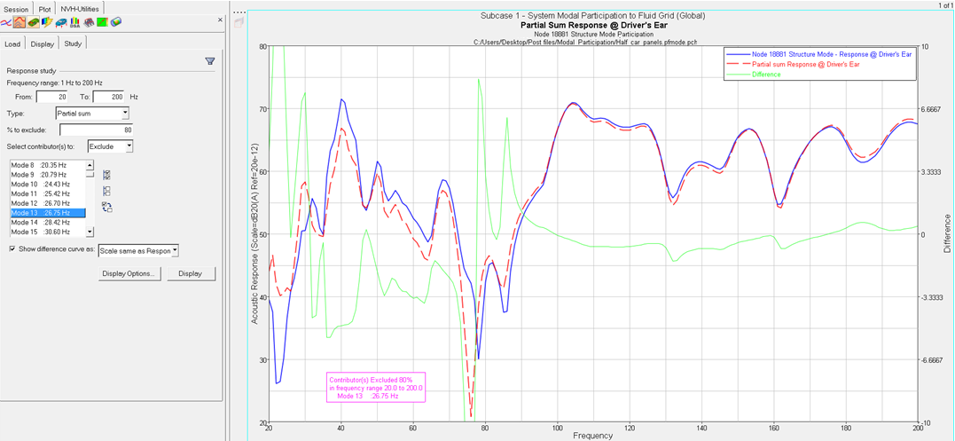

- Partial sum study
- Select a number of contributors to exclude from the response, with an optional percentage to exclude.

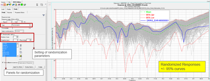

- Randomization
- Select modes/panels for randomization.
- % to Exclude
- Optional field that allows you to exclude a percentage of the contributors from the response.
- Randomization Options
- These options are active only when the Randomization option is chosen from the Type drop-down menu. You can enter the number of randomization runs in addition to the magnitude and phase for the randomization of modes/panels.
- Select contributor(s) to:
- Select the mode/panel or modes/panels that you want to exclude or
include in the response study.
- Click
to select the entire list of
contributors. - Click
to deselect your current
selections. - Click
exchange the currently selected
contributors for the unselected contributors in the list.
- Click
- Show difference curve as
- Shows the difference between the original curve and the partial sum curves.

Figure 1. Response study plot
Figure 2. Randomization plots
