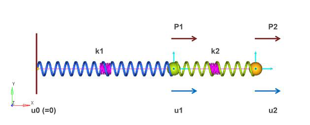

Two springs are connected in series. The stiffness of spring-1 is k1 and that of spring-2 is k2. One end of spring-1 is fixed to ground while a force, P1, acts at the other end. Spring-2 is subjected to a force of P2 at the other end.
The objective of the analysis is to determine the sensitivities of stiffnesses of the springs to displacements u1 and u2 and use them to identify or tune k1 and k2 of the system to achieve specific values of u1 and u2.
MotionSolve's DSA (Design Sensitivity Analysis) capability to calculate sensitivities is utilized in this example. A Step-by-step procedure to define and run the model is given in the tutorial.
Figure 1 shows that problem setup. Properties used in the problem are also provided.
Figure 1. Springs in Series – Model DescriptionA list of properties for the system follows:- Displacement: u0 =0 (Fixed)
- Force:
- P1 = 1N
- P2 = 2N
- Stiffness:
- k1 = 2 N/mm
- k2 = 3 N/mm
- Response Variables (RV): u1 and u2
- Design Variables (DV): k1 and k2
- Analysis Type: Static Analysis with DSA

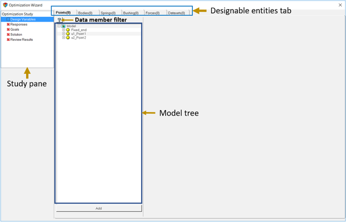

The process of optimization starts with setting up a model in MotionView. MotionView’s Optimization Wizard is used to setup design variables, responses and objectives. The wizard also guides the user to run and plot/print results of optimization. It is also able to export a design from a particular iteration into a new MDL for further analyses.

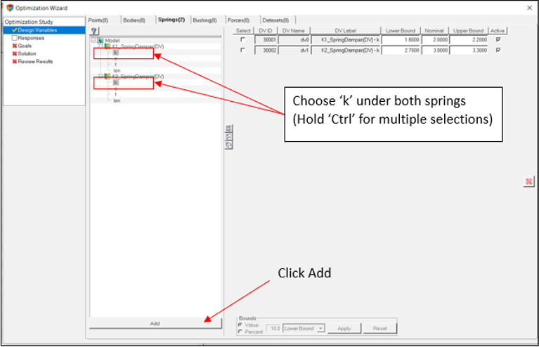

Add Design Variables
In this step, you will add design variables for the optimization.

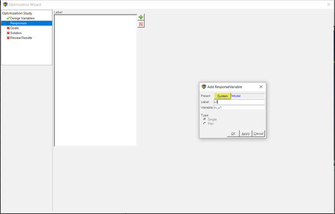

Add Response Variables
In this step, you will add response variables for the optimization.
- Displacement u1: To make u1 to reach a value of 3, the metric (1-u1/3)**2 is used.
- Displacement u2: To make u2 to reach a value of 4, the metric (1-u2/4)**2 is used.

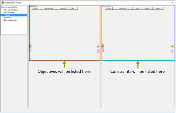

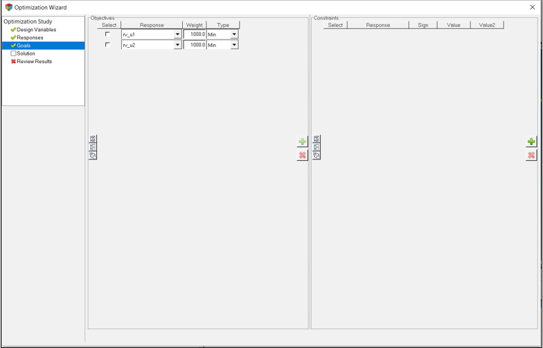

Add Objectives and Constraints
Now you will add two objectives to the problem.

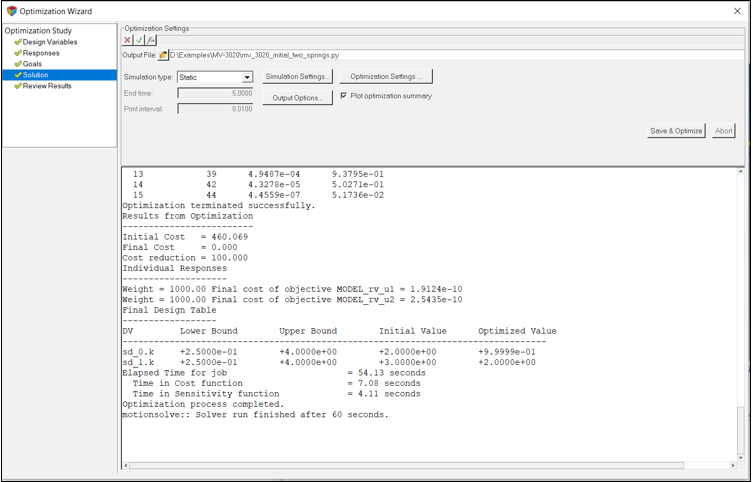

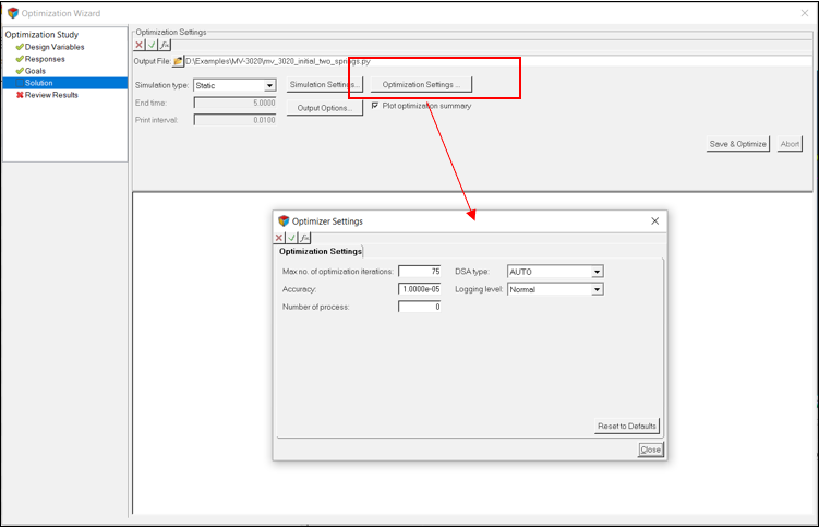

Run the Optimization
In this step you will run the optimization.

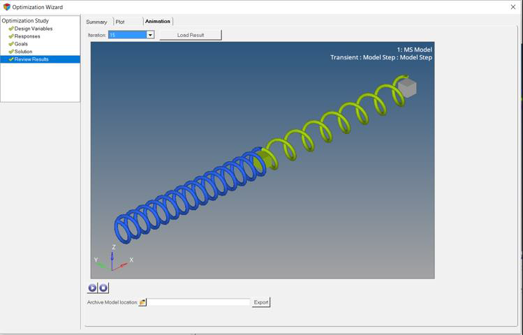

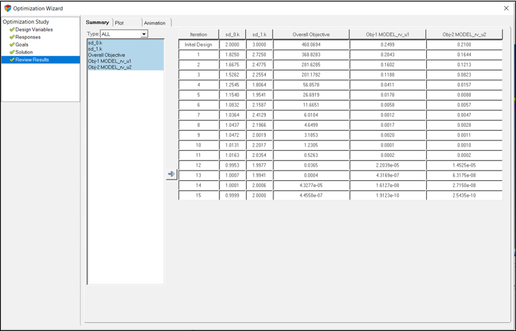

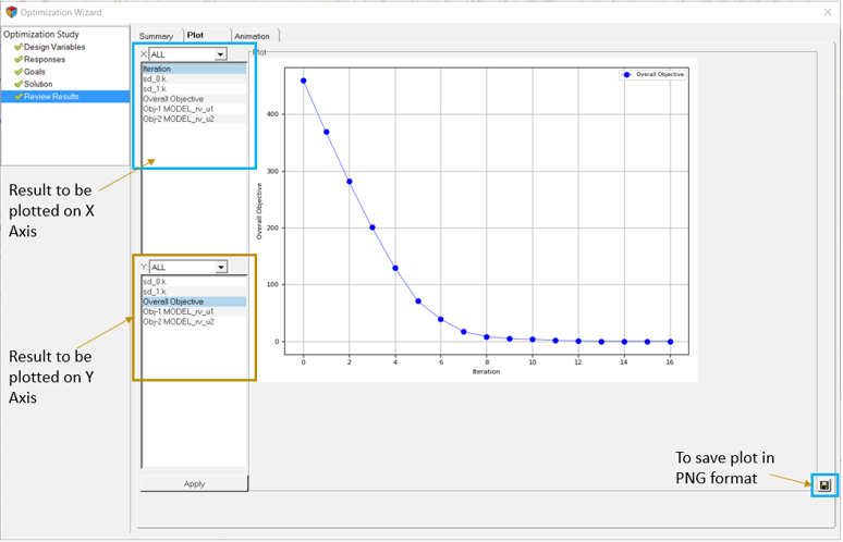

Post-Process
In this step, you will post-process the results of optimization.
