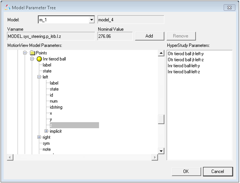

You can then select MDL property data as design variables in a DOE or an optimization exercise. Solver scripts registered in the MotionView Preferences file are available through the HyperStudy interface to conduct sequential solver runs for DOE or optimization.

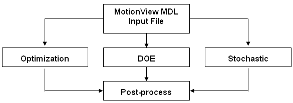

For any study, the HyperStudy process is shown below:
The HyperStudy Process

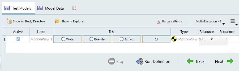

MotionView MDL files can be directly loaded into HyperStudy. Any solver input file, such as MotionSolve, ADAMS, or Abaqus, can be parameterized and the template file submitted as input for HyperStudy. The parameterized file identifies the design variables to be changed during DOE, optimization, or stochastic studies. The solver runs are carried out accordingly and the results are then post-processed within HyperStudy.

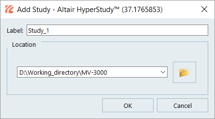

Copy the files hs.mdl and target_toe.csv, located in the mbd_modeling\doe folder, to your <working directory>.

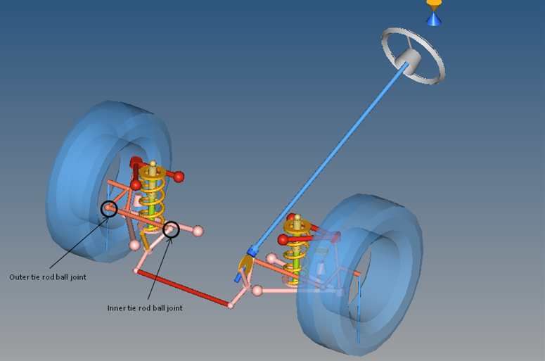

In the following steps, you will create a study to carry out subsequent DOE study on a front SLA suspension model.

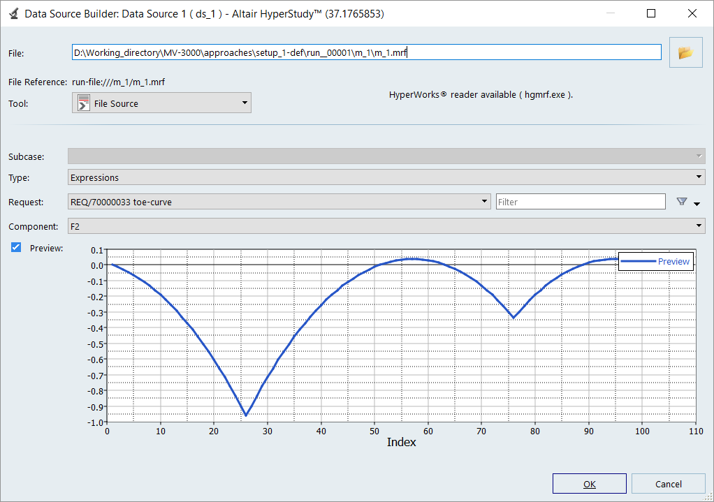

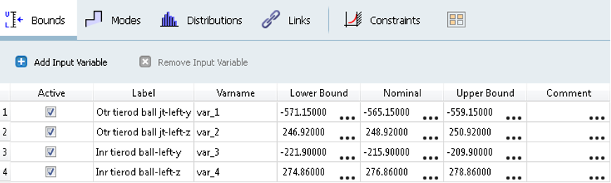

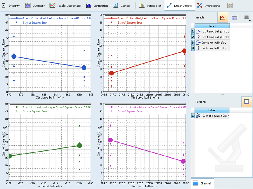

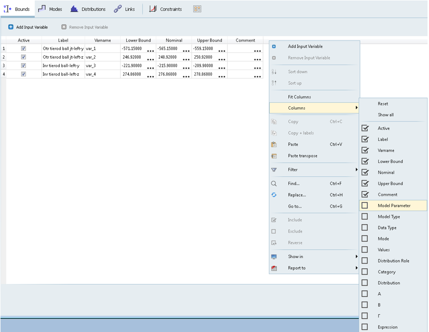

While performing a Static Ride Analysis, you will determine the effects of varying the coordinate positions of the origin points of the inner and outer tie-rod joints on the toe-curve.

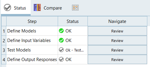

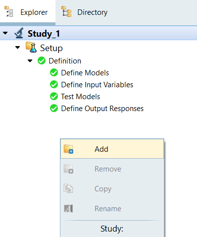

Step 1: Study Setup
Or, from the menu bar, select .

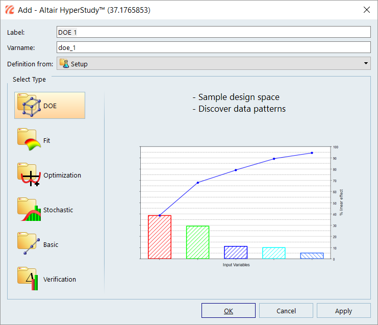

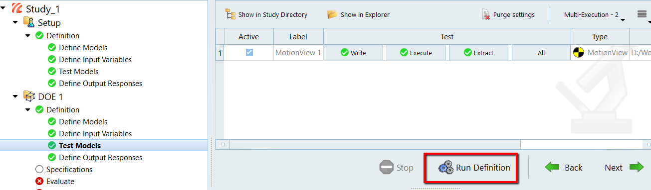

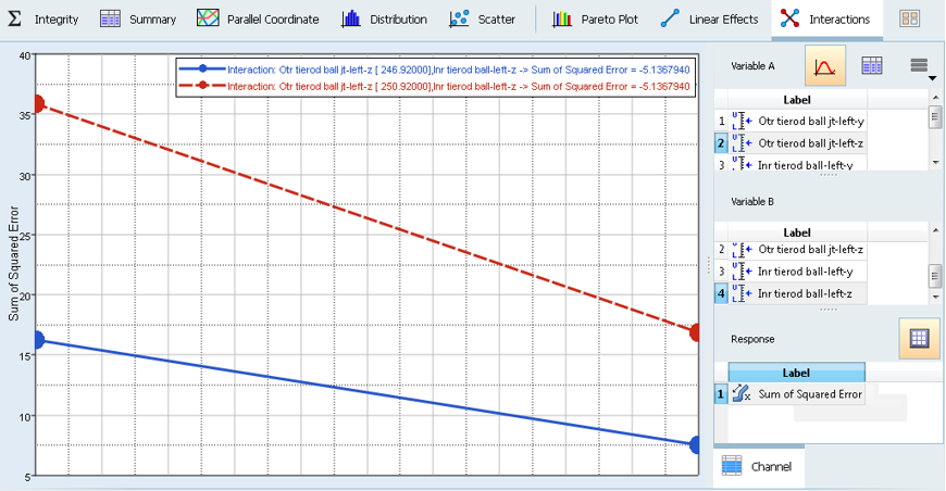

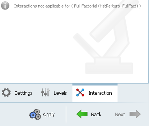

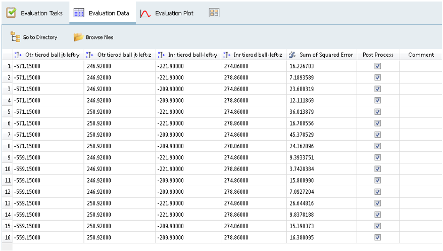

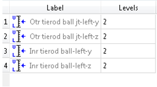

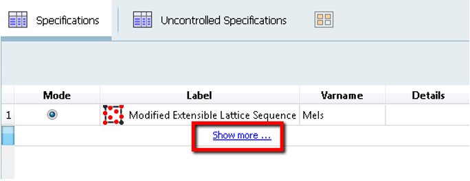

Step 2: DOE Study

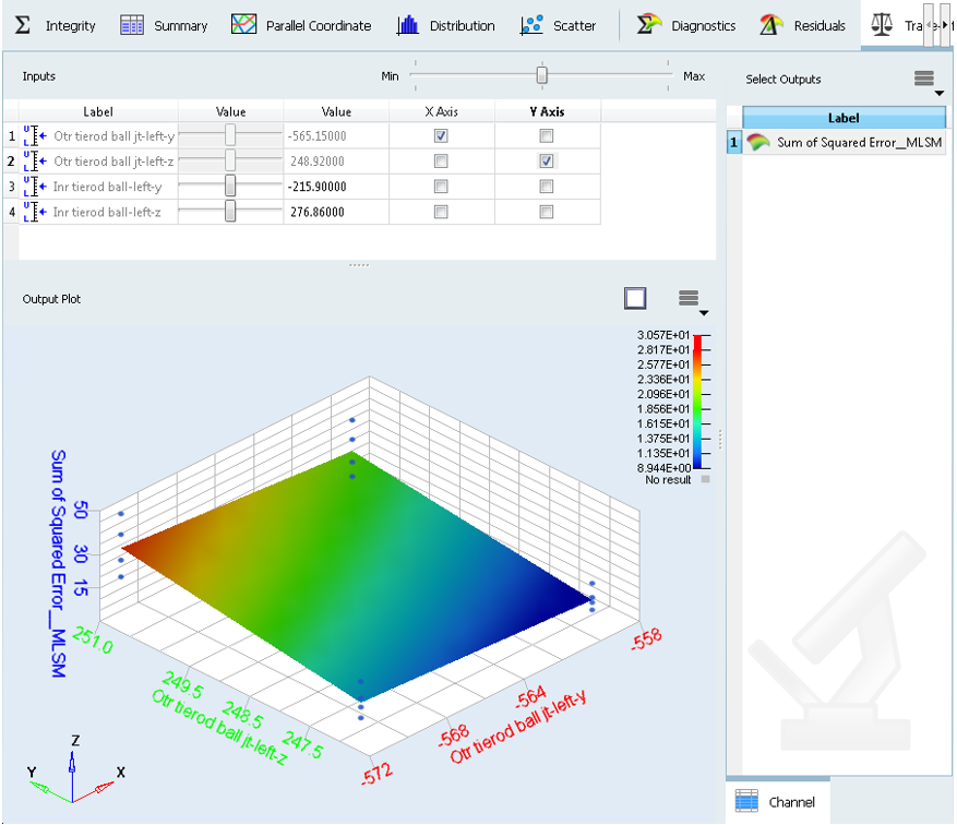

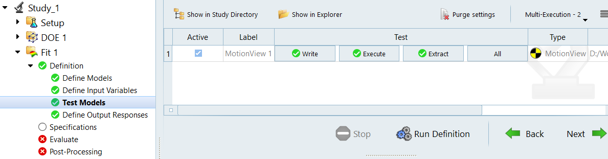

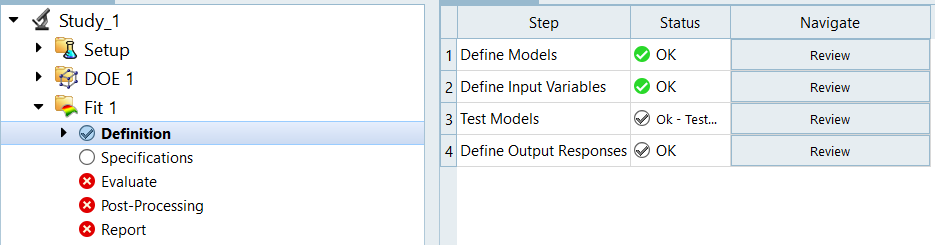

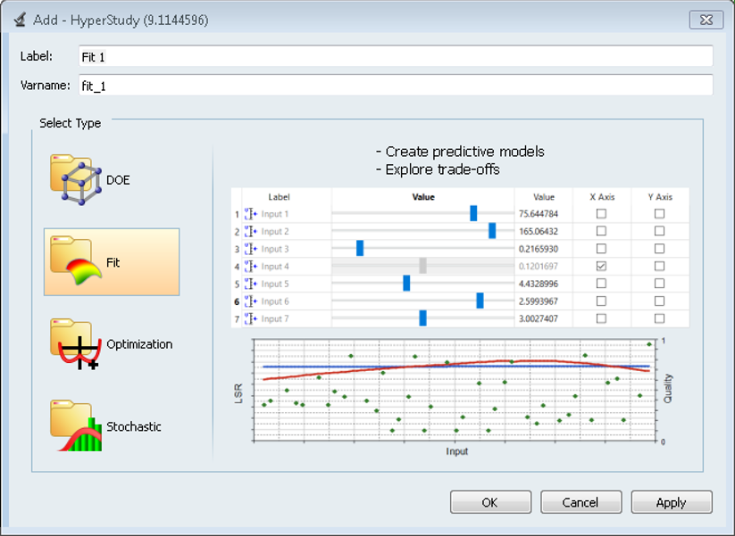

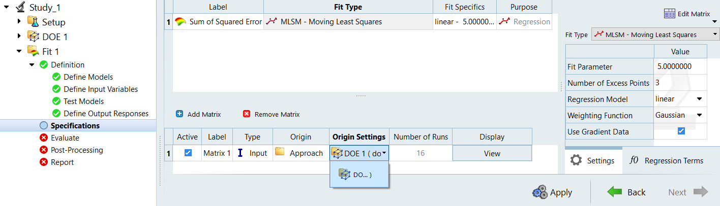

Step 3: Approximation

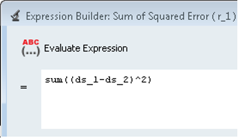

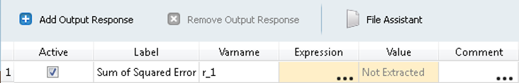

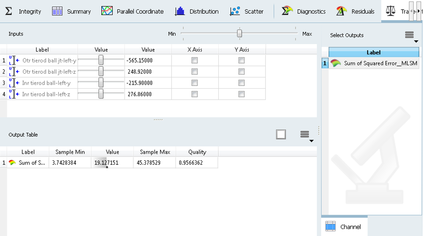

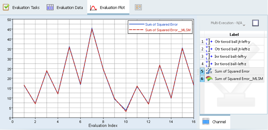

System response is approximated by using various curve fitting methods. An approximation for the response with the design variables variation is calculated using the data from above DOE study. The accuracy of the approximation can be checked and improved.

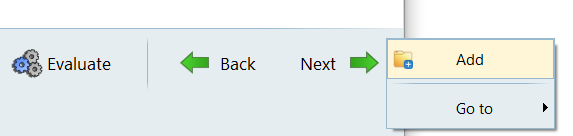

Adding an approximation.
Define specifications.
to open the Add Model dialog.
