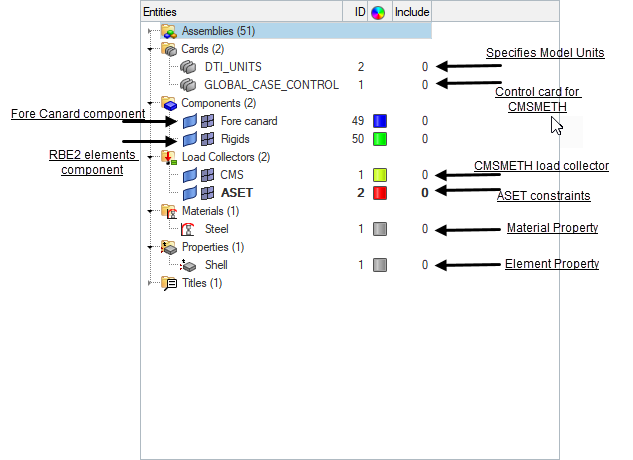

Open ForeCanard.hm in HyperMesh with OptiStruct selected as the user
profile.
Review the model.

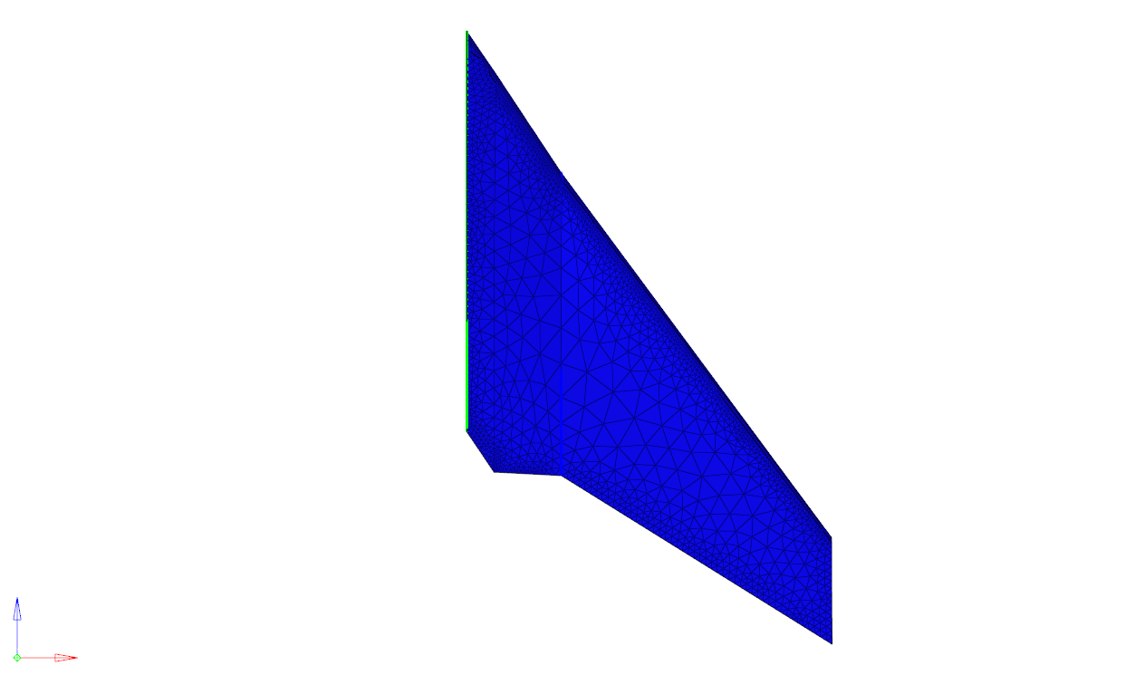

The HM file contains a meshed model of Fore Canard with material
properties and control cards defined.
Figure 3. HyperMesh Model Browser
Note: Model units are Newton-Meter-KG-Sec, therefore all properties
defined are consistent with this unit system.

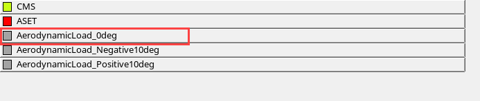

Add load collectors for three cases:
Left-click on the Load Collector icon from the toolbar.
In the panel, verify that the create radio
button is selected.
Specify the new load collector name as
AerodynamicLoad_0deg.
In the drop-down menu, select no card
image.
Click Create.
Figure 4.
Follow steps 3.a through 3.e to
create two more load collectors named
AerodynamicLoad_Negative10deg and
AerodynamicLoad_Positive10deg.
Click Return.

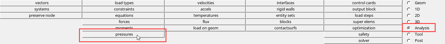

Browse to the Pressure load panel.
Click the Analysis radio button.
On the Analysis page, click on the Pressure
button.
Figure 5.
This will open the pressure panel.

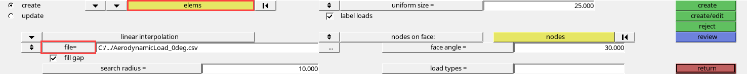

Set the pressure load type to linear
interpolation.
Verify that the create radio button is
selected.
Figure 6.

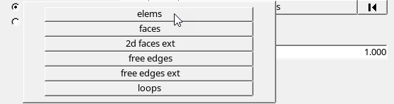

Next to the faces button, click the drop-down
arrow. Change the surface selection type from faces to
elems.

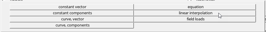

In the magnitude drop-down menu, click linear
interpolation.
Figure 9.
Figure 10.

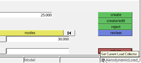

Left-click on Set Current Load Collector.
Figure 12.
From the load collector list, choose
AerodynamicLoad0_deg.
Figure 13.
This will set AerodynamicLoad_0deg as the current load

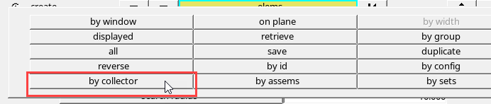

Click the elems button. Select by
collector from the list.
Figure 14.
Figure 15.
From the component collector list, click Fore
Canard. Click the select button
to return to the pressures panel.

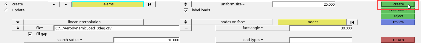

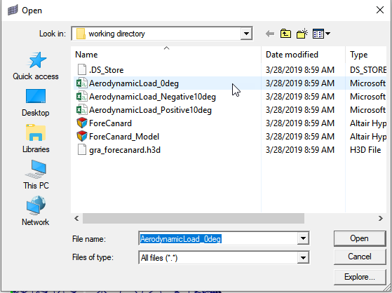

Click the ellipse button to browse for a
file.
Figure 17.
In the Open dialog, browse your
<working directory> and select
AerodynamicLoad_0deg.csv. Then click
Open.
Figure 18.
Click create to create pressure loads for the
0deg position.
Figure 19.
Figure 20.

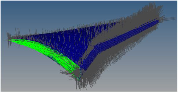

Note: The pressure load on each element is obtained by a linear
interpolation of pressure values with respect to its
location.

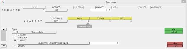

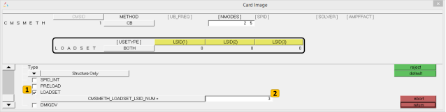

Specify load sets for CMS method.
Three load cases modeled in previous step represent nodal forces. These nodal
forces are transformed as modal forces using CMS method. In this step you modify
the existing CMSMETH card image to include three load sets.

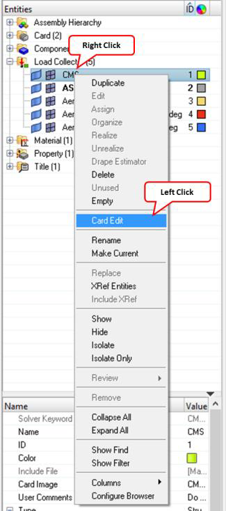

In the Entities browser, right-click on the CMS
load collector.
In the context menu, click Card
Edit.
Figure 21.

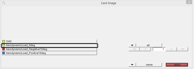

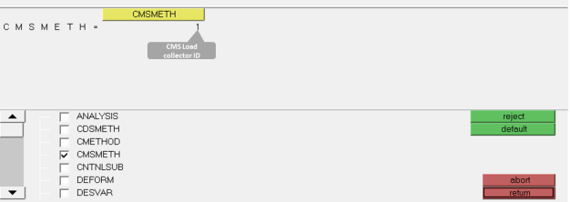

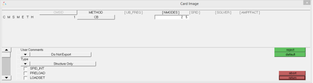

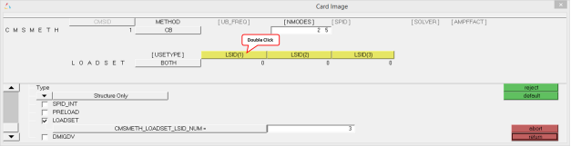

This will open the load collector card image. Figure 22.
Specify load sets for CMSMETH.
In the Card Image dialog, activate the
LOADSET checkbox.
Specify the CMS_LOADSET_LSID_NUM value as
3.
Figure 23.
The card image shows an option to specify three load sets.
Double-click LSID(1).
Figure 24.
From the load collectors list, click
AerodynamicLoad_0deg. Click the
return button to go back to the CMS card
image.
Figure 25. Figure 26.
Use steps 8.c and 8.d to
specify AerodynamicLoad_Negative10deg for LSID(2)
and AerodynamicLoad_Positive10deg for
LSID(3).
Click Return.

In the next card, click on GLOBAL_CASE_CONTROL
to see the CMS load collector specified for CMSMETH solution. Click
return twice.

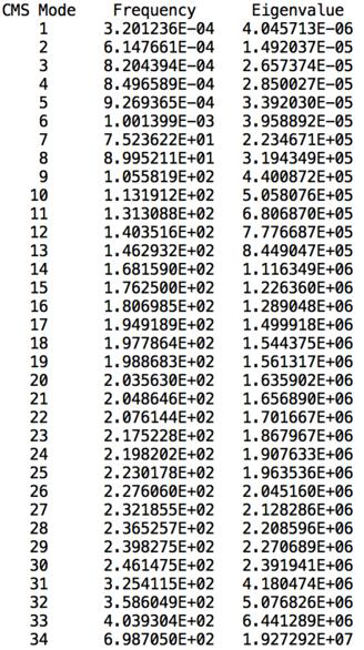

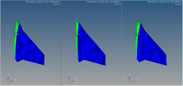

Review flexbody modes.
On successful completion of solver run, open the flexbody
flex_ForeCanard.h3d created from OptiStruct run in HyperView to review the various mode shapes. Your
flexbody contains 34 modes constituting normal modes, constraint modes,
and Static modes. Figure 32. Figure 33. Figure 34.

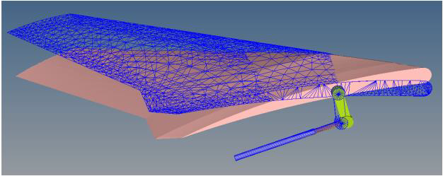

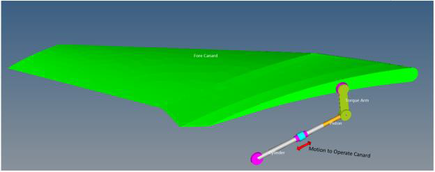

A MotionView model of the fore canard mechanism has
been provided. In this model, the Fore Canard body is modeled as a rigid body. In this
next step we will replace the rigid Fore Canard body with a flexible body created in the
previous step and use ModalForce entities to scale the pressure loads with respect to
canard position.
Open the ForeCanard_Model.mdl in MotionView. Review the model.
The model contains the following elements:
Four bodies namely Fore Canard, Torque Arm, Piston, and Cylinder.
A motion on the Piston with an expression 0.025*SIN(2*PI*TIME) to extend
and retract the piston by 25mm at 1 Hz. This piston motion varies the
fore canard angular position between -9.619 deg to +9.984 deg. Figure 35.

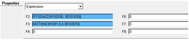

An expression type Output request to measure the “ForeCanard angular
position” and “Piston force along its axis”. The Fore canard angular
position is measured from the
RevJnt_TorqueArm_Gnd joint rotation
angle using the expression
`RTOD({j_4.AZ})`. The Piston force is
measured from the Piston Motion using the expression
`MOTION({mot_0.idstring},{0},{4},{j_2.i.idstring})`.

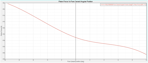

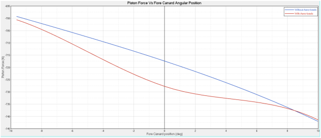

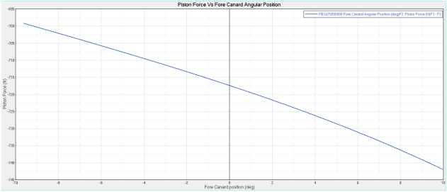

Use the data in Table 1and Table 2 to plot the Piston Force versus Fore Canard Angular
Position in HyperGraph.
Table 1.
X-axis Data
X Type
Expression
X Request
REQ/70000000 Fore Canard Angular Position
(deg)F2, Piston Force (N)F3
X Component
F2
Table 2.
Y-axis data
Y Type
Expression
Y Request
Y Component
F3
Figure 38.

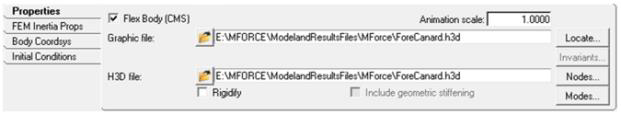

Switch the rigid fore canard to a flexible body.

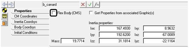

From the Project Browser, select the
Fore Canard body.
In the Body panel, activate the Flex Body(CMS)
check box.
Figure 39.
Browse your <working directory> and specify
flex_ForeCanard.h3d for the Graphic and H3D
files.
Figure 40.
Click the Nodes button and resolve the flexbody
interface nodes.

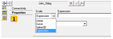

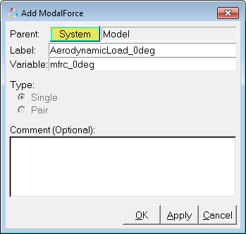

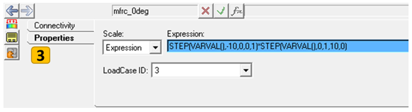

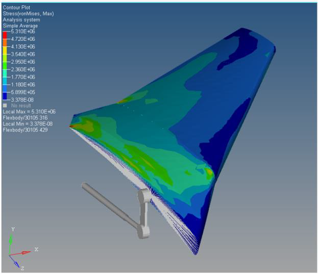

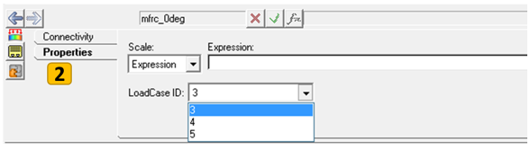

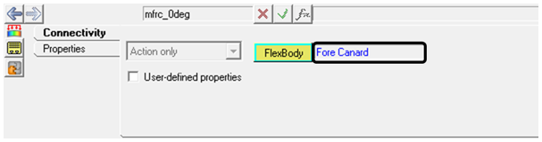

Model Aero-dynamic loads through Modal Force Entity.

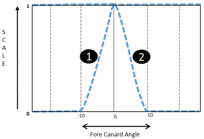

The aero-dynamic loads are estimated at three distinct positions of canard
namely - 10 deg, 0deg, 10deg. Assume each pressure load to linearly vary in
interval ±10deg on a 0 to 1 scale. This variation of the aero-dynamic loads is
achieved by scaling Modal Forces with respect to canard angle using an
expression.

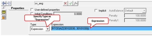

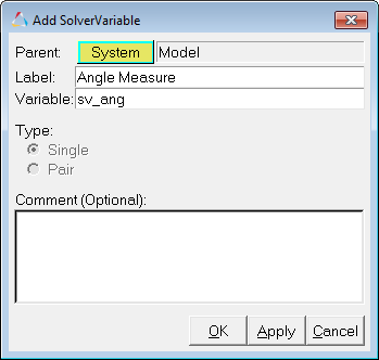

Right-click on the (SolverVariable) icon.
In the dialog, specify the Label as Angle
Measure and the Variable name as
sv_ang.
Figure 41.
Click OK.
In the SolverVariable panel, under the Properties
tab, specify the Type as Expression and enter
`RTOD({j_4.AZ})` in the Expression
field.
Figure 42.
After completing steps 5.a through
5.d,
you have created an explicit variable that measures the fore Canard
angle.
On the Force Entity toolbar, right-click on the (ModalForce) icon.
Figure 43.
In the Add Modal Force dialog, specify the Label
as AerodynamicLoad_0deg and the Variable name as
mfrc_0deg.
Figure 44.
Click OK.
This will display the ModalForce panel.
Configure the ModalForce panel.
In the Connectivity tab, specify Fore Canard for
the Flexbody.
Figure 45.
From the Properties tab, specify the Scale type as
Expression, the LoadCaseID as
3, and the Expression as
`STEP(VARVAL({sv_ang.idstring}),-10,0,0,1)*STEP(VARVAL({sv_ang.idstring}),0,1,10,0)`.
Figure 46. Figure 47. Figure 48.
The product of the two STEP functions evaluates to gradually
increasing the value of the scale from 0 to 1 and then back to 0, while
the canard angular position varies from -10deg to 10 deg as shown in the
expression in Figure 49: Figure 49. Figure 50.
