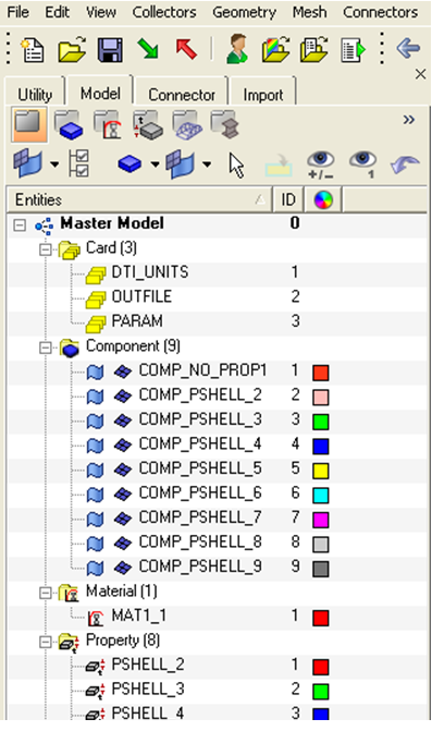

Review the Finite Element Model for the Flexible Door
In this step, you will review the contents of the finite element (FE) model, which is the starting point for creating a flexible body.

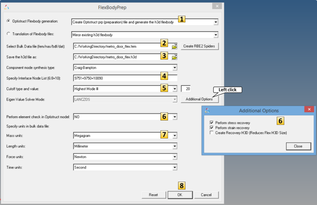

Generate the Flexbody using Flex Prep
In this step, you will use the FEM file created in Step 1 and use Flex Prep to generate a flexible body H3D file. A pre-requisite for going through this step of the tutorial is an understanding of Flex Prep as described in MV-2010: Flexbody Generation using Flex Prep and OptiStruct.

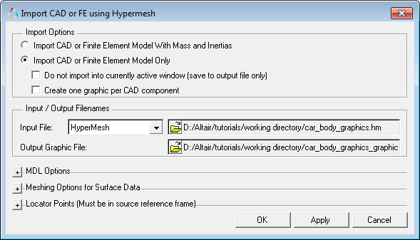

Graphics
After Point 6 above, you can see that the Door Body has a graphical representation, but Car Body does not. You can add a file graphic to the Car Body so that visualization of the model becomes more meaningful.
