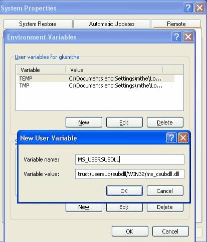

Create an environment variable MS_USERSUBDLL and set the value to the DLL
file.
- For Windows 64-bit platform users, set the value to <installation_directory>\hwsolvers\motionsolve\usersub\subdll\win64\ms_csubdll.dll.
- Right-click on the My Computer icon. From the Advanced tab, select Environment variables > New (under User variables).
- Set Variable name to MS_USERSUBDLL.
Set Variable value to

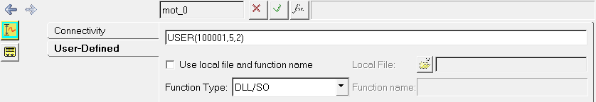

- From the Connectivity tab, check the User-defined properties check box.
Click the User-Defined tab and enter
USER(100001,5,2) in the
text-box.
Figure 2.Note: To use an element level (specific) DLL/Interpreter function, you can check the Use local dll and function name check-box and point to the DLL using the folder icon,
.The string
USER(100001,5,2)is used to pass arguments to the MOTSUB user subroutine. The MOTSUB user subroutine calculates motion using the parameters par1 and par2 in USER(branch_id, par1, par2) as follows:motion_val= par1*TIME^par2 -

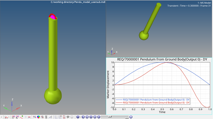

- In the plot window, plot the results from the ABF file Pendu_model_usersub.abf to overlay the results on top of the results from the Pendu_model.abf file
- In the animation window, check the Overlay option on the Load Model panel.
Select the file Pendu_model_usersub.h3d using the
Load model folder icon
Click Apply.
This will overlay the new animation over the existing animation.
Figure 3.Note: If the value of the usrsub_param_string is set as "USER(3.142, 1)" the results from step 2 will be the same as results from step 1. - Open the MotionSolve XML file Pendu_model.xml (saved in step 1) from the working directory.
