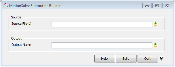

Use the MotionSolve Subroutine Build Tool to Create Shared Libraries
The Altair Subroutine Builder is included in the MotionSolve installation for both Windows and Linux.
Follow these steps to build a MotionSolve-compatible shared library using available source code.

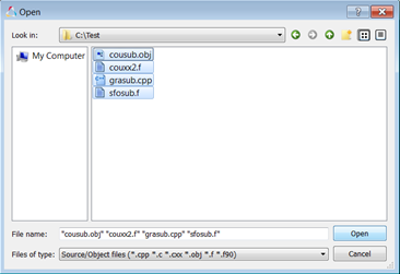

Specify Source Code or Object Files
- C/C++ source code (*.c, *.cpp, *.cxx)
- FORTRAN source code (*.f, *.f90)
- FORTRAN or C/C++ object files (*.obj in Windows, *.o in Linux)

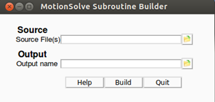

- A combination of the above.Note: The remainder of this section demonstrates using the build tool on Windows. The steps for using the tool on Linux are identical.Important: The source code or object files must all be located in the same directory. You must have write-to-disk permissions for this directory. If you do not have write-to-disk permissions for this directory, please copy the source code to a location where you do have write-to-disk permissions.
Also, if your source/object code is located in different folders on your disk, please copy all source/object code, along with any relevant files (like headers, for example) to one common directory. Use this as your working directory in the following steps.

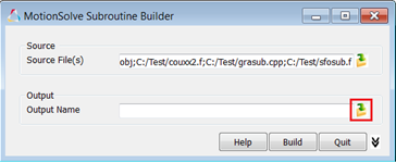

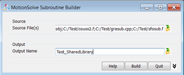

Specify the Output Directory
Next, you will specify the output directory where you would like the shared library to be built. Again, you must have write-to-disk permissions for this directory.

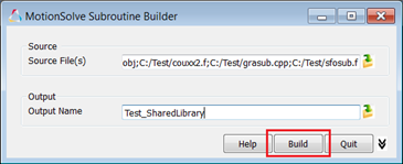

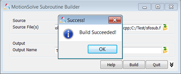

Build the Shared Library

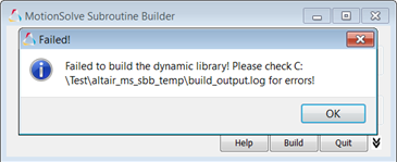

I am not able to compile Fortran files even though I have a supported Intel Fortran compiler installed. What's wrong?
The build tool relies on an environment variable to detect the version of the Intel Fortran compiler and its location on your machine. Make sure you have the environment variable IFORT_COMPILERxx (where xx is the version of the compiler - 10, 11 or 12) defined correctly on your system and pointing to the installed version.

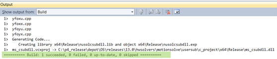

Use the Microsoft® Developer Studio to Build a Shared Library
To successfully build a shared library using the steps below, you will need to have write-to-disk permissions for your HyperWorks installation directory.
Building a C++ User Subroutine DLL using Microsoft® Visual Studio®
Building a FORTRAN User Subroutine DLL using Microsoft® Visual Studio®
The same steps can be repeated to build a FORTRAN user subroutine DLL for MotionSolve. The only difference is that the Visual Studio project file to be opened is ms_fsubdll.vfproj. All the other steps remain the same.
