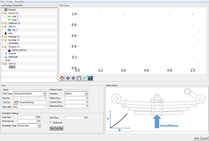

The Test component is required to define the options in the Test Properties section.
You can add any number of tests that stroke the spring to determine the spring’s force-deflection curve and stiffness, either with the shackle (slipper end) as if the spring was installed in the vehicle or without the shackle (SAE J510). The inputs that describe a test are described below.

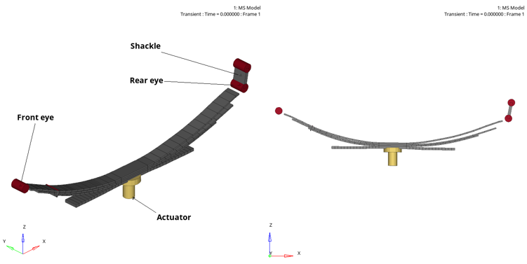

- Test Type: Spring and Shackle strokes the spring as mounted in the
vehicle.

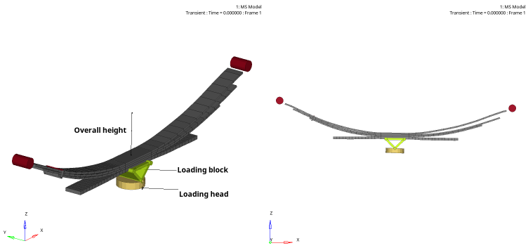

- Test type “Spring Only” strokes the spring without the shackle following the SAE J510 guidelines to generate the spring’s characteristic Force vs Deflection curve. For this test the spring eyes contact a flat plate and a displacement is input via a loading block on the bottom of the spring. In an actual test the spring is inverted and pushed downward into a plate. In the Leaf Spring Builder, gravity is directed in the +Z direction effectively inverting the spring and the centers of the spring eyes or the spring tips for slipper ends are constrained by in-plane joints.
Spring and Shackle - Force/Motion Inputs
- Actuator
- Select Force or Motion to determine how the input applied to the spring.
- Offset Force/Displacement
- Enter the offset force or displacement from which the test begins. The offset is relative to initial load or position of spring as built.
- Jounce Force/Displacement
- Enter the increment of force or displacement relative to the initial force of displacement for jounce. The sum of the offset force and jounce force give the maximum force applied to the spring, if the actuator is force. Likewise, the sum of the offset displacement and jounce displacement give the maximum displacement applied to the spring, if the actuator is motion.
- Rebound Force/Displacement
- Enter the decrement (positive value) of force or displacement relative to the offset force or displacement for rebound. For a force actuator, the difference between the offset force and rebound force gives the minimum force applied to the spring. For example, if the initial force is 1000 N and the rebound force is 1000 N, then the minimum force in the test is zero (free position). For a motion actuator, the difference between the offset displacement and rebound displacements gives the minimum spring displacement.
Spring-only (SAE J510) - Motion Inputs
Only motion inputs are supported for the Spring Only (SAE J510) test.- Curb
- Enter the increment of spring displacement from the initial spring position to curb position.
- Design
- Enter the increment of spring displacement from curb position to design position.
- Metal-Metal
- Enter the increment of spring displacement from design position to metal-metal position.
The total spring displacement from the initial position is sum of the curb, design, and metal-metal values.
Simulation Settings
- Print Interval
- Enter the time between output steps. The end time divided by the print interval gives the number of outputs steps.
- Step Size
- Enter the time between solution steps. The step size must not be greater than the print interval.
- Simulation Type
- Select Quasi-static or Transient. Quasi-static simulation removes inertia and damping forces. Transient simulation includes damping and inertia forces. It is recommended that you select Quasi-static. If there are problems obtaining a solution, then switch to transient. When using transient simulations, consider using larger end times to slow the rate of change of spring deflection to reduce inertia and damping forces.
- End Time
- Enter the end time of the simulation. Simulations start at time=0, hence the end time is also the duration of the simulation.
- Build Leaf
- Check the build leaf box to build the leaf spring before running the test. You should check the box if you have changed the spring tag that defines if the leaf spring that is loaded in the Leaf Builder has to be built when the Run Test Rig button is clicked.
- Run Test Rig
- Click the Run button to run the simulated leaf spring test.
