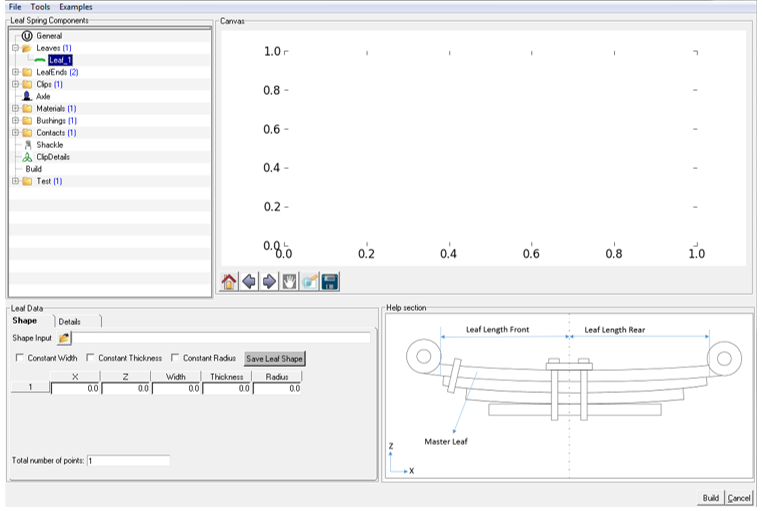

The Leaves component allows you to add a stack of leaves, with each subsequent leaf shorter than the previous one.
Figure 1. Leaves Component - Leaf Data
The information that has to be entered in the Shape and Details tabs in order to add a Master Leaf is explained in the following sections.

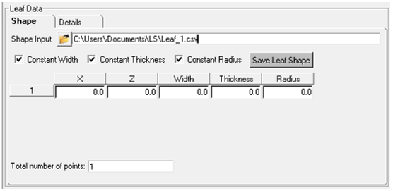

Shape
- X
- Represents the x co-ordinate of leaf profile
- Z
- Represents the z co-ordinate of leaf profile.
- Width
- Defines the leaf width. Tip: For constant width, only the first row needs to have the appropriate value, the rest of the rows must be zeroes.
- Thickness
- Defines the leaf thickness. Tip: For constant thickness, only the first row needs to have the appropriate value, the rest of the rows must be zeroes.
- Radius
- Defines the side fillet radius.Tip: For constant radius, only the first row needs to have the appropriate value, the rest of the rows must be zeroes.
- Constant Width
- Activate to have the same values appear along the entire length of the leaf.
- Constant Thickness
- Constant Radius
- Save Leaf Shape
- Saves the entered leaf data in a .csv file format.
Figure 2. Leaf Data - Shape Tab
Refer to Shape Input for Leaf Property File for more information on how it is represented in the TiemOrbit file format.

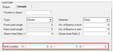

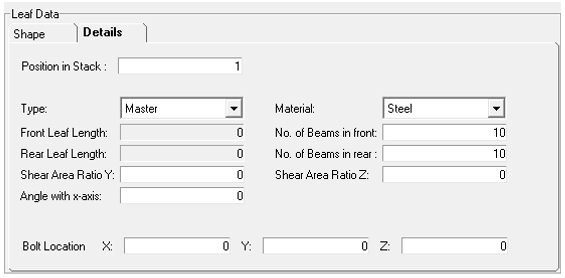

Details
The options used in the Details tab are explained below.
Figure 3. Leaf Data - Details Tab
- Position in Stack
- Defines the position of the leaf in a leaf stack.

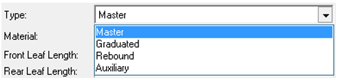

- Type
- Defines the type of a leaf.
- Master: The top leaf in the spring which has the spring eyes.
- Graduated: Remaining leaves are called as Graduated leaves, with varying lengths.
- Rebound: Any leaf that appears above the master leaf and is part of the pack.
- Auxiliary: These are usually the helper leaf modeled at the bottom of the pack to provide additional stiffness whenever system is at a certain jounce.
Figure 4. Available Leaf Types - Material
- Defines the material used in a leaf.

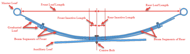

- Front Leaf Length
- This is a read-only field and its values are auto-calculated. It provides length for the front half of the leaf from the center bolt.
- Rear Leaf Length
length for the rear half of the leaf from the center bolt.
For leaves with eyes, the length (Front/Rear) will be up till the point where the leaf starts curving into the eye profile. In other words, it indicates that length of the leaf which needs to be discretised using beam elements.
- No. of Beams in front
- Represents the number of beam elements that will make up the front half of the leaf.
- No. of Beams in rear
- Represents the number of beam elements that will make up the rear half of the leaf.
- Shear Area Ratio Y
- Defines the shear ratio along Y direction.
- Shear Area Ratio Z
- Defines the shear ratio along Z direction.
Figure 5. Detailed Leaf Spring for Leaf Details
Refer to Leaf List for Leaf Property file for more information on how it is represented in the TiemOrbit file format.
Bolt Location
Bolt Location is required only if the shape condition is Pre-Assembly. It provides the bolt location of a leaf as its reference location and generates correct leaf profiles from Pre-Assembly Shape condition.
Figure 6.
Refer to Bolt Location for Leaf Property file for more information on how it is represented in the TiemOrbit file format.

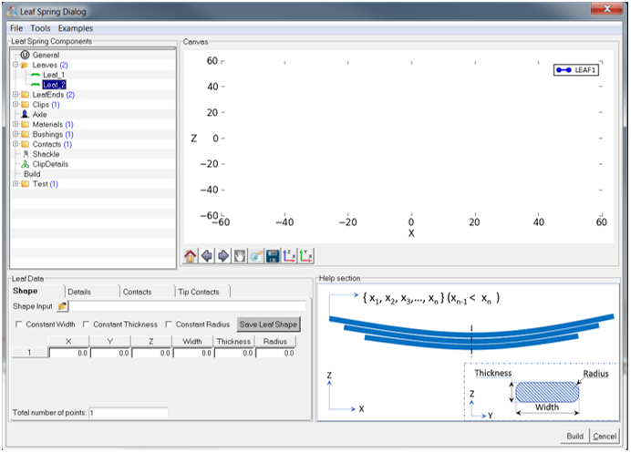

Adding Additional Leaves to the Leaf Stack (Graduated and Auxiliary Leaves)
Additional leaves can be added to the Leaves component. You will have to define the necessary points in the contact table to have contact between the upper leaves.
Figure 7. Leaves - Leaf Data

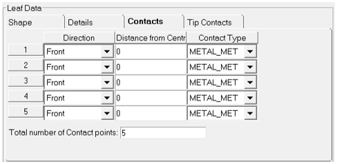

Contacts
Contact points provide contact between the current leaf and upper leaf. In this section you can define the number of contact points and enter the required data in the table.
Figure 8. Leaf Data - Contacts Tab
- Contact Number
- Defines the serial number of contact points which should be unique for the front and rear direction.
- Direction
- Defines the direction of contact from the center bolt.
- Distance
- Defines the distance of contact from the center bolt along the leaf length in either front/rear direction. While mentioning this, you will have to note the lengths of the current leaf and the leaf above it.
- Contact Type
- Defines the label of the contact properties that you have define in the contact properties component.
Refer to Contact Table for Leaf Property File (*lpf) for more information on how it is represented in the TiemOrbit file format.

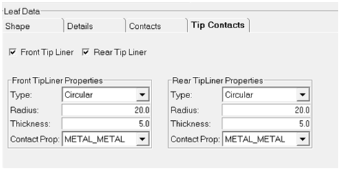

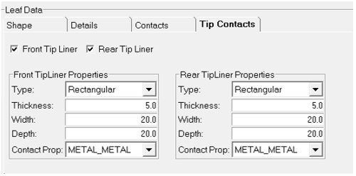

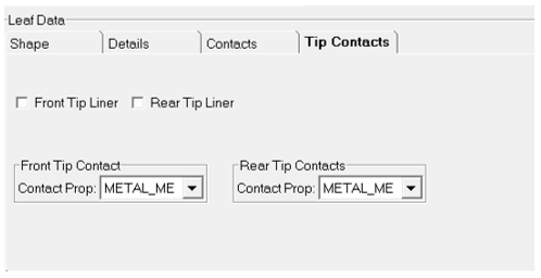

Tip Contacts/Tip Liners
Tip liners are usually present in the leaf ends. Tip liners influence how the spring works. They are used to reduce the interleaf friction. Depending your needs, tip liners may have to be invoked. Tip liners can be at both ends or at one, as per your requirement.- Type
- Defines the shape of the tip liner.
- Radius
- Defines the radius of the tip liner.
- Thickness
- Defines the thickness of the tip liner.
- Contact Properties
- Defines the label of the contact properties that you have defined in the contact properties component.
Figure 9. Leaf Data - Tip Contacts Tab with Tip Liner Option 'Off'
Figure 10. Leaf Data - Tip Contacts Tab with Tip Liner Option 'On'
- Type
- Thickness
- Width
- Defines the width of the tip liner.
- Depth
- Defines the depth along the leaf.
Figure 11.
Refer to Tipliner Front/Tipliner Rear for Leaf Property File (*lpf) for more information on how it is represented in the TiemOrbit file format.
