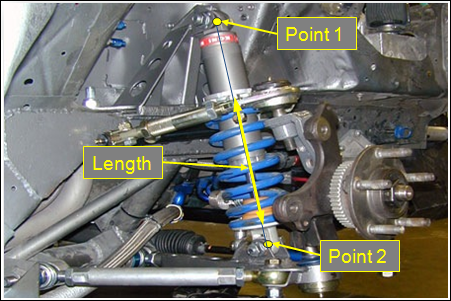

- Points
- The distance between Points 1 and 2 fixes the initial length of the Spring and hence
its force. Any changes in the location of Points 1 and 2 affect the Spring’s length,
initial force, and line of action. The initial length
(l0)of the Spring is:
(1)
Figure 1. - Length

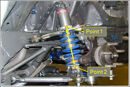

- Enter the length of the Spring to fix its load. Altering the locations of Points 1
and 2 changes the line the Spring acts along, but not the Springs initial length and
force.
Figure 2. - Force
- Enter the initial force in the Spring. Any changes in the locations of Points 1 and 2 only affect the Spring’s line of action. Further, changes to the Spring properties like free length and stiffness do not affect the initial force. At initialization of the solver an iterative method is used to determine the Spring length that yields the entered force.
