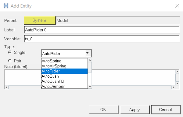

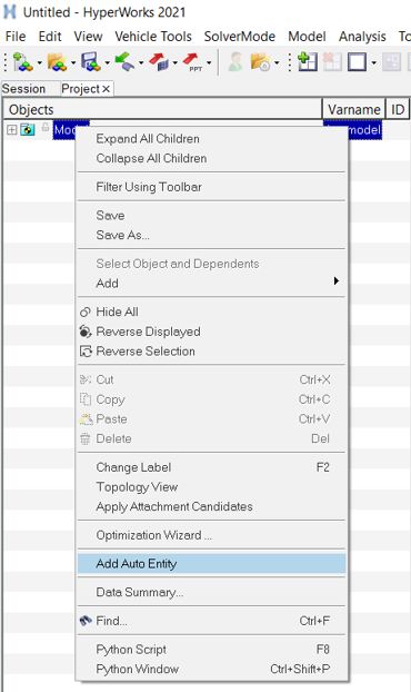

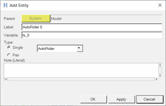

The following steps outline how to add an AutoRider to the model:- Right-click on the Model in the Project Browser and click
Add Auto Entity.
Figure 2.The Add Auto Entity dialog is displayed.
Figure 3.- OK
- Applies the selected type and closes the window.
- Apply
- Adds the Auto Entity without closing the window.
- Cancel
- Exits the Auto Entity dialog.
- Select the AutoRider from the drop-down menu.
Figure 4. - Click OK.
The AutoRider Entity is added to the Project Browser.
- The AutoRider panel is displayed in the panel area.

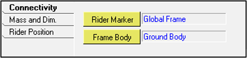

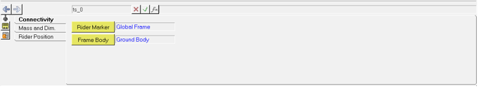

Figure 5. - Resolve the Rider Marker and Frame Body attachments to locate the AutoRider.
Figure 6.Reference Description Rider Marker Reference marker to locate the AutoRider, provides an initial frame of reference. Frame Body To fix the AutoRider to the vehicle body.

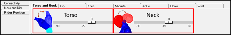

- Torso and Neck
Figure 8.Parameter Description Torso Input for the torso angle about y direction. You can use the slider to vary the angle. Limits of the field can be changed by updating the values of AY_pel data member in the "MN angles” and "MX angles” data sets. Neck Input for the neck angle about y direction. You can use the slider to vary the angle. Limits of the field can be changed by updating the values of AY_nec data member in the "MN angles” and "MX angles” data sets.

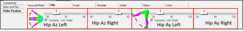

Figure 9.Parameter Description Hip Az Left Input for the left hip angle about z direction. You can use the slider to vary the angle. Limits of the field can be changed by updating the values of AZ_hip_l data member in the "MN angles” and "MX angles” data sets. Hip Az Right Input for the right hip angle about z direction. You can use the slider to vary the angle. Limits of the field can be changed by updating the values of AZ_hip_r data member in the "MN angles” and "MX angles” data sets. Symmetry: L->R Check the box to mirror the values from left to right. It makes the right limb angle field read only. Hip Ay Left Input for the left hip angle about y direction. You can use the slider to vary the angle. Limits of the field can be changed by updating the values of AY_hip_l data member in the "MN angles“ and "MX angles“ data sets. Hip Ay Right Input for the right hip angle about y direction. You can use the slider to vary the angle. Limits of the field can be changed by updating the values of AY_hip_r data member in the "MN angles“ and "MX angles“ data sets. Symmetry: L->R Check the box to mirror the values from left to right. It makes the right limb angle field read only. - Knee

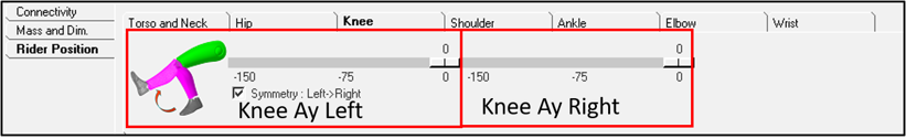

Figure 10.Parameters Description Knee Ay Left Input for the left knee angle about y direction. You can use the slider to vary the angle. Limits of the field can be changed by updating the values of AY_kne_l data member in the "MN angles“ and "MX angles“ data sets. Knee Ay Right Input for the right knee angle about y direction. You can use the slider to vary the angle. Limits of the field can be changed by updating the values of AY_kne_r data member in the "MN angles“ and "MX angles“ data sets. Symmetry: L->R Check the box to mirror the values from left to right. It makes the right limb angle field read only. - Shoulder

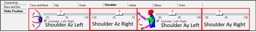

Figure 11.Parameter Description Shoulder Az Left Input for the left shoulder angle about z direction. You can use the slider to vary the angle. Limits of the field can be changed by updating the values of AZ_sho_l data member in the "MN angles“ and "MX angles“ data sets. Shoulder Az Right Input for the right shoulder angle about z direction. You can use the slider to vary the angle. Limits of the field can be changed by updating the values of AZ_sho_r data member in the "MN angles“ and "MX angles“ data sets. Symmetry: L->R Check the box to mirror the values from left to right. It makes the right limb angle field read only. Shoulder Ay Left Input for the left shoulder angle about y direction. You can use the slider to vary the angle. Limits of the field can be changed by updating the values of AY_sho_l data member in the "MN angles“ and "MX angles“ data sets. Shoulder Ay Right Input for the right shoulder angle about y direction. You can use the slider to vary the angle. Limits of the field can be changed by updating the values of AY_sho_r data member in the "MN angles“ and "MX angles“ data sets. Symmetry: L->R Check the box to mirror the values from left to right. It makes the right limb angle field read only. - Ankle

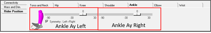

Figure 12.Parameters Description Ankle Ay Left Input for the left ankle angle about y direction. You can use the slider to vary the angle. Limits of the field can be changed by updating the values of AY_ank_l data member in the "MN angles“ and "MX angles“ data sets. Ankle Ay Right Input for the right ankle angle about y direction. You can use the slider to vary the angle. Limits of the field can be changed by updating the values of AY_ank_r data member in the "MN angles“ and "MX angles“ data sets. Symmetry: L->R Check the box to mirror the values from left to right. It makes the right limb angle field read only. - Elbow

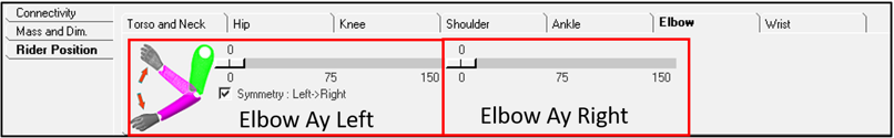

Figure 13.Parameters Description Elbow Ay Left Input for the left elbow angle about y direction. You can use the slider to vary the angle. Limits of the field can be changed by updating the values of AY_elb_l data member in the "MN angles“ and "MX angles“ data sets. Elbow Ay Right Input for the right elbow angle about y direction. You can use the slider to vary the angle. Limits of the field can be changed by updating the values of AY_elb_r data member in the "MN angles“ and "MX angles“ data sets. Symmetry: L->R Check the box to mirror the values from left to right. It makes the right limb angle field read only. - Wrist

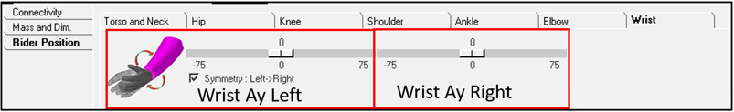

Figure 14.Parameters Description Wrist Ay Left Input for the left wrist angle about y direction. You can use the slider to vary the angle. Limits of the field can be changed by updating the values of AY_wri_l data member in the "MN angles“ and "MX angles“ data sets. Wrist Ay Right Input for the right wrist angle about y direction. You can use the slider to vary the angle. Limits of the field can be changed by updating the values of AY_wri_r data member in the "MN angles“ and "MX angles“ data sets. Symmetry: L->R Check the box to mirror the values from left to right. It makes the right limb angle field read only.
