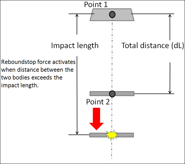

- Impact Length Method
- When the impact length is of value ‘L’, the AutoReboundStop force acts when the distance between the two bodies is less than ‘L’.

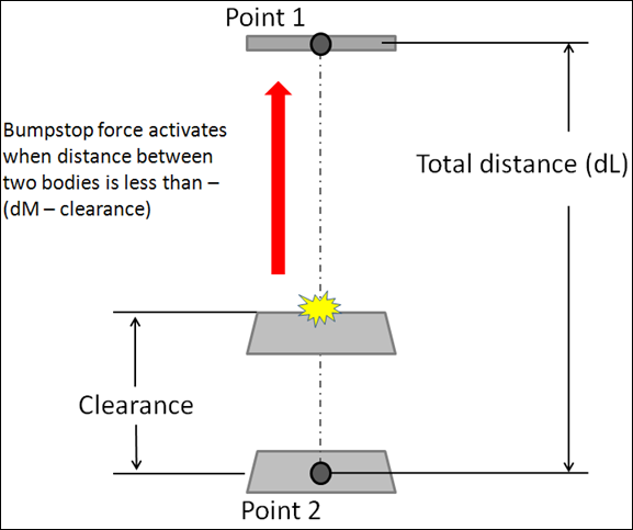

- Clearance Method
- When the Clearance method is used, the impact distance is calculated
using:
