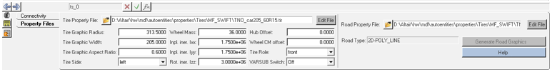

Auto Tire- Property Files Tab
- Tire Property File
Parameter Description Tire Property File Browse and select the required file. Edit File Edit the file and save the edited file. Tire Graphic Radius Distance between the WC and the contact point of tire in unloaded conditions. Tire Graphic Width Section width of the tire. Tire Graphic Aspect Ratio Describes the sidewall height as a percentage of the tire section width. Tire Side Defines the left or right side of the tire. Wheel Mass The meaning of wheel mass changes with a tire model. Fiala, Simplified durability tire Mass of rim + Mass of Tire MF-Tyre, MF-SWIFT Mass of the rim + Mass of tire ‘Mass of tire’ should include the tire belt mass which can be read from Tire property file (INERTIA block) or it can be read from MotionSolve log file. FTire Mass of the rim + Mass of ‘rim-fixed’ tire parts Or
Mass of the rim + Mass of the tire – Mass of the ‘free’ tire parts
rim-fixed tire parts are not accounted in FTire model, only ‘free’ tire mass is accounted. These masses can be read from the tire property file or can be read from the MotionSolve log file. CDTire Mass of the rim + Mass of ‘rim-fixed’ tire parts Or
rim-fixed tire parts are not accounted in the CDTire model, only ‘free’ tire mass is accounted. These masses can be read from the tire property file or can be read from the CDTire log file. Inpl.Iner.Ixx, Inpl.Iner.Iyy Moment of Inertia of the wheel in the wheel plane. Adjust the wheel inertia per the tire model by including the inertias of tire fixed parts that are not accounted for in the tire models.
Rot.Iner.Izz Moment of inertia of the wheel about the spin axis. Adjust the wheel inertia by including or excluding the inertias of tire parts that are accounted for or not accounted for in the tire models.
Hub Offset Defines the offset of Hub graphic center from the wheel center. Wheel CM offset Defines the wheel part CM offset from the wheel center. Tire Role Defines tire function: front or rear. VARSUB Switch Activates the solver variables that contains the tire’s states. This option can be used for control prototyping. - Road Property File
Parameter Description Road Property File Property File option is used to browse and select the required road property file. Edit File Edit file button is used to edit the road property file and save the edited file. Method Defines the road model type. Road Type Defines the type of road. Function Name Name of the function being called by Solver.

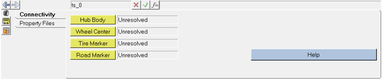

Auto Tire- Connectivity Tab
| Connection | Significance |
| Hub Body | The wheel body on which the tire forces act. |
| Wheel Center | The point corresponding to the wheel center. |
| Tire Marker | The tire marker determines the direction in which the tire forces act. |
| Road Marker | The road marker, is the marker with respect to which the road is positioned and oriented for the simulation. |
