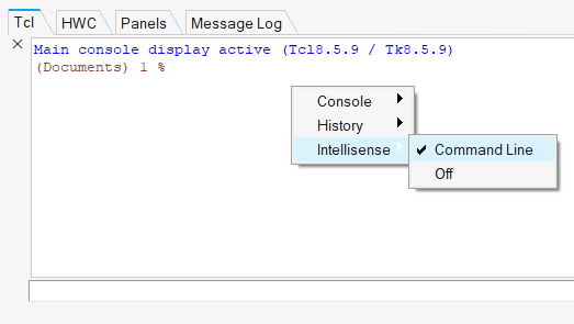

Activating Command Line
displays the Tcl/Tk command line at the bottom of the console. You
can type commands which contain Tcl
handles and a popup Intellisense window is shown above the command

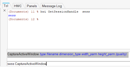

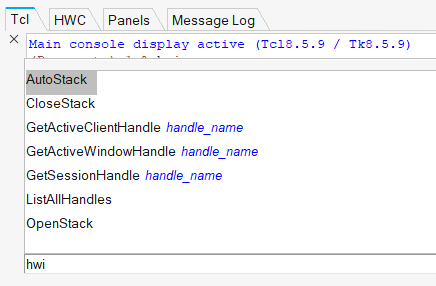

Select Command Names
Variables are supported. When a valid handle is set to a variable, typing that variable name preceded by a dollar sign, $, invokes the Intellisense popup for that handle.

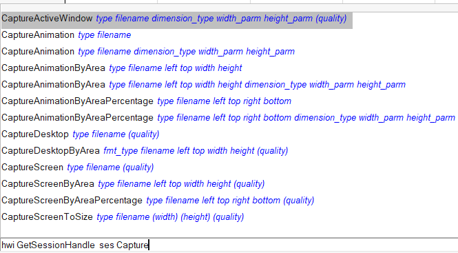

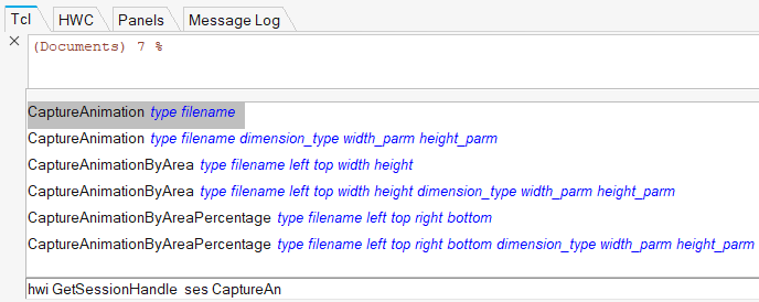

The more specific you are with the text you enter, the fewer choices are displayed, as shown in the two examples below.
Figure 3.
Figure 4.

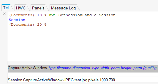

Figure 5.
Figure 6.
Figure 7.

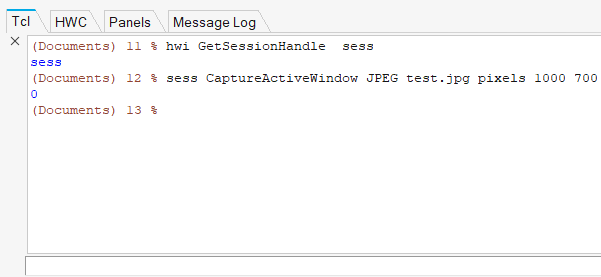

After executing the command, the command line is empty and the command is displayed in the Tcl Console.
Figure 8.
The file test.jpg is created.
