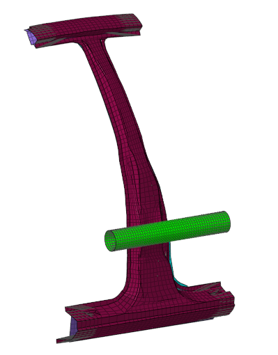

The model used for the optimization is a B-Pillar cut from a full car model. An initial velocity is applied to a rigid cylinder in the transverse (Y) direction.
The objective of the optimization is to minimize the mass of the B-Pillar while constraining the maximum displacement of a node on the inner panel to less than 19.7 mm.

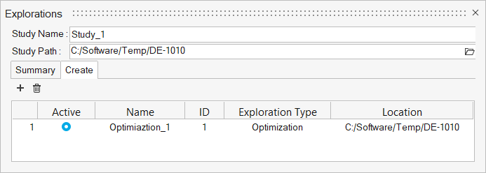

Create an Exploration
From the Design Explorer ribbon, Exploration tool group, click the
Create Explorations tool.
Figure 2.The Explorations dialog opens. -
Click
then select Optimization.
In the Study Path field, browse to and select the folder to store your
optimization.
Figure 3. -

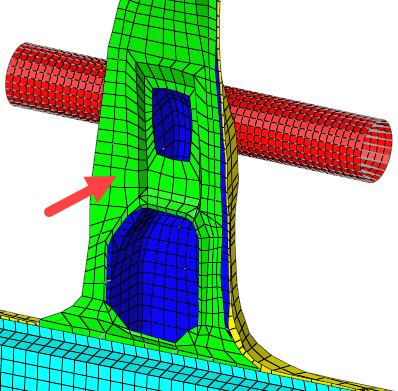

In the modeling window, select the green
Inner property.
Figure 6. -
In the microdialog, click the drop-down on the left and
select Bounds=, then set the upper bound to
0.5 and the lower bound to
3.0.
Figure 7. -
Click Create.
A gauge design variable is created.

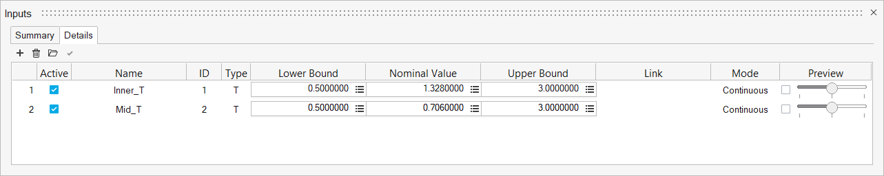

On the ribbon, hover over the Gauge tool then click the satellite icon
The Review Inputs dialog opens. - Click the Details tab.
For the Mid_T design variable, modify the Lower Bound and Upper Bound to
0.5 and 3.0
respectively.
Figure 10.

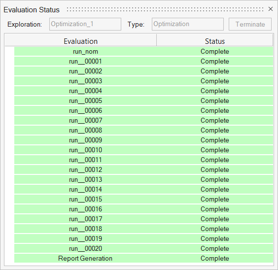

Figure 16.The Evaluate dialog opens. - Change the Number of runs to 20.
Click Export then click
Run.
The optimization is evaluated. In this case, there will be a nominal run plus 20 optimization runs.
This may take a few minutes depending on your computer.
When the evaluation is complete, the Evaluation Status dialog should look like the following.
Figure 17.

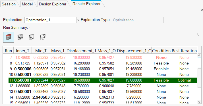

Figure 18.The Results Explorer opens. -
Review the Summary table, which shows the input, objective, and constraint
values for each run of the optimization.
Figure 19.The values for the optimal thicknesses found from the optimization are indicated by a green background, and additional feasible designs are indicated as well. Orange font indicates that at least one constraint is nearly violated. Red font indicates runs with at least one violated constraint.

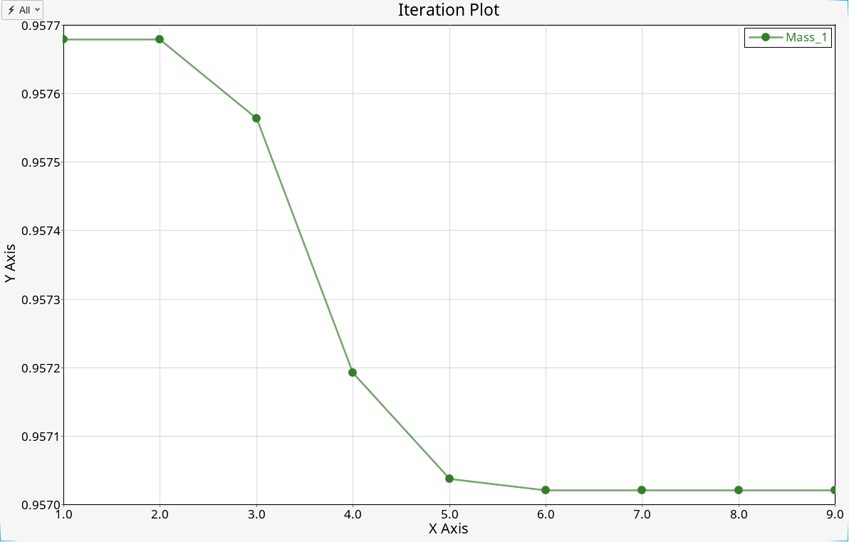

In the Results Explorer, click the Iteration Plot button
In the Entity selection area, check the Mass_1 response.
Notice how the objective varied and was minimized during the optimization.
