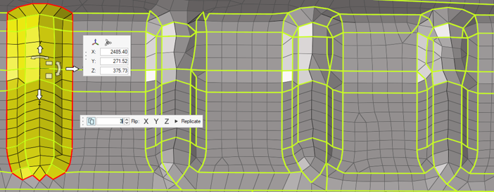

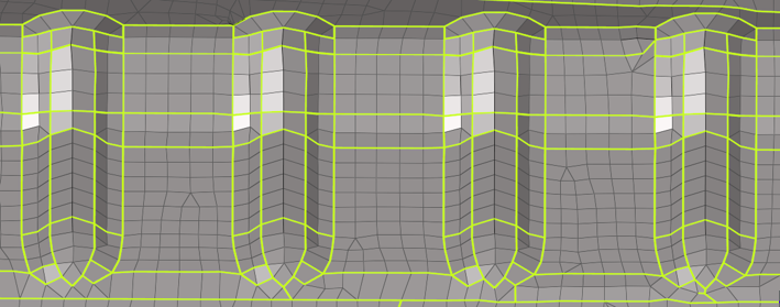

Use the Replicate tool to replicate a mesh from one location to another, with options to keep the original mesh, as well as to replicate into multiple copies. The replicated elements replace the original elements, maintaining relevant information like properties, thicknesses, and other solver attributes.
This is useful when there are multiple instances of the same feature in a model. You may clean and prepare the mesh for just one of the instances, and then replicate those changes to the other locations. This is also useful for making design changes, such as moving a feature from one location to another or creating multiple instances of a feature.

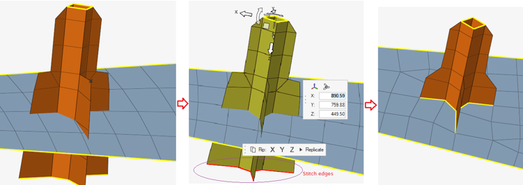

- Extend
- This function comes in handy when extending or trimming the feature to
the base mesh. Refer to the example images below from left to right for
an illustration of the usage.Note: In this case, the copy option is turned off in order to trim the base mesh with the feature and create conformal feature edges on the base (as shown in the right most image).

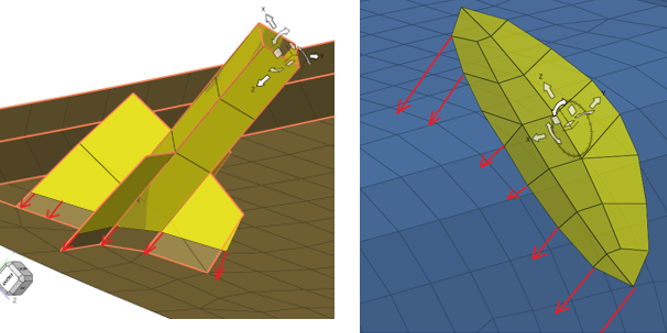

- None
- If you would like to maintain the source topology unchanged, it is recommended to use this mapping method. In the following example, the left bead has been used as a source topology.
