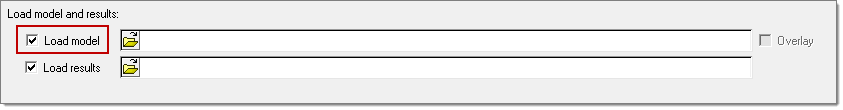

Activate the Load Model check box to enable the Load Model panel and then click on the file
browser button
to open the Load Model
File dialog, where you can select the *.log file of the
CFD analysis.

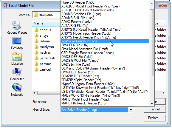

The AcuSolve reader can be explicitly selected by clicking on the Files of type: pull-down menu and selecting AcuSolve Reader (*.Log). Once the AcuSolve reader has been selected, only the AcuSolve *.log files will be displayed in the directory.
The selected *.log file contains a link to the AcuSolve result file directory, in general ACUSIM.DIR, from which the relevant result data will be extracted.

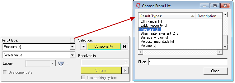

After loading the result files, the result types for nodal_output and for extended_nodal_output will be displayed in the selection list for contour plotting. The derived_quantity_output is included in the extended nodal output.
Figure 3.
