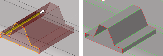

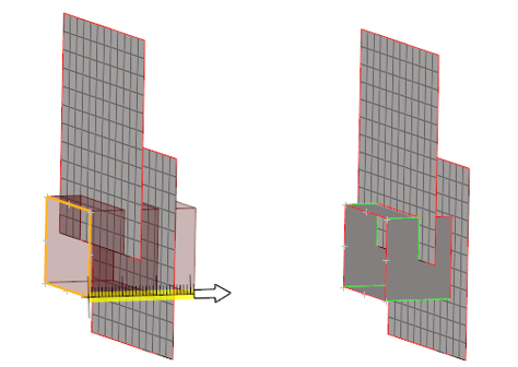

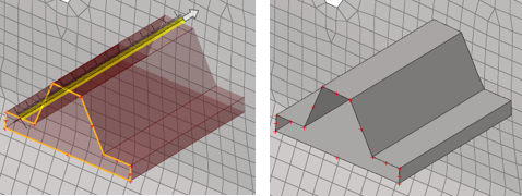

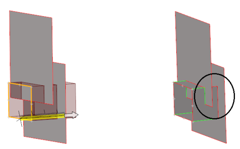

While dragging lines or nodes, if a continuous surface or mesh is intersected and this option is ON, the newly created surfaces are trimmed at the intersection. The auto-trim option works for both geometry intersecting geometry and mesh. It also works for FE topology intersecting FE topology.
Figure 2. Surfaces intersecting with surfaces
Figure 3. Surfaces intersecting with mesh
Figure 4.
Figure 5.
