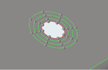

- A Washer split anchor is added for quick execution of the
split. You can select a line, usually a free edge with a
cutout to create the split. This is useful when creating a
washer split around a hole. A specific distance can be
entered into the microdialog.
