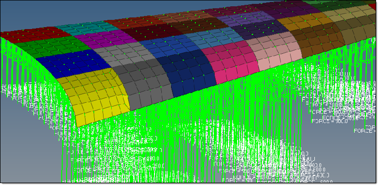

Perform nodal force balance mapping using OptiStruct to
ensure mapped target nodal forces and source nodal forces are in equilibrium.
Forces from a source model are mapped to new target model nodal forces. The total
load calculation on the source model and the new mapped model must be the same in order
to ensure forces are balanced.

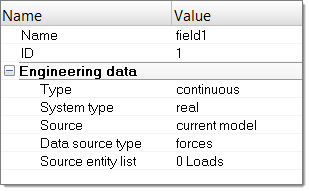

Create and define a field entity:
In the Model Browser, right-click and select Create > Field from the menu.
In the Entity Editor, define the nodal field
using the current model and forces data source, then select the loads to
map.

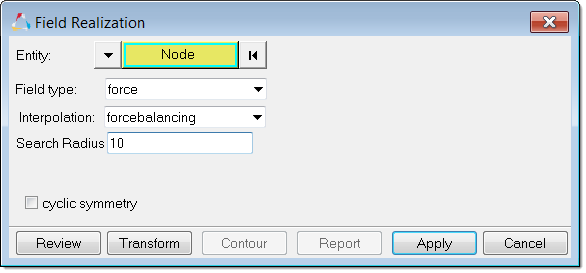

Realize the field:
In the Model Browser, right-click on the
field and select
Realize from the menu.
In the Field Realization dialog, define the
realization settings.
Figure 3.
Set Interpolation to forcebalancing.
Click Apply.

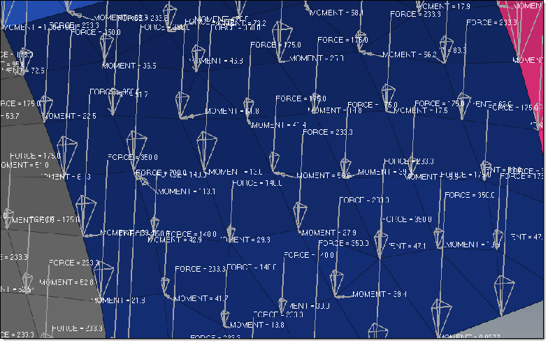

New forces and moments are created and applied to the nodes of
the target mesh. Figure 4.
