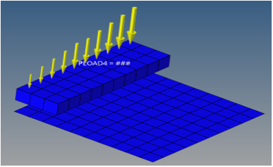

- Vector Plots – display value distribution with the direction of the load

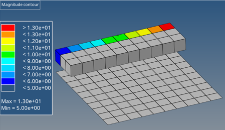

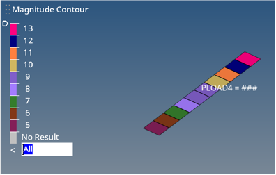

Figure 1. - Advanced Contour Plots – display value distribution with interactive filters
Figure 2. - Contour Plots – display value distribution with respect to the entire model
Figure 3.
