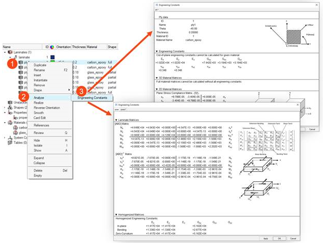

Engineering Constants

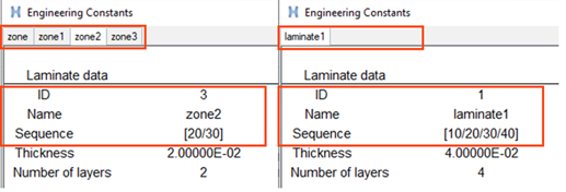

- Selection of multiple entities of the same type is also supported and generates multiple tabs in the Engineering Constants result view which contain the corresponding results.
- Results can be marked with left-click (or Ctrl + left-click for multiple results) and then saved to clipboard with Ctrl + C for transfer to spreadsheet.
- Engineering constants
- 2D/3D material matrices
Calculations are output in the material system. Note that 3D properties can only be calculated for materials which provide the necessary data (for example, OptiStruct MAT9OR).

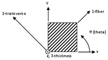

Calculations are output in the laminate’s material reference orientation. Accordingly, the ply angle entered in the ply Orientation field is used to transform the properties from ply fiber direction to the laminate material reference orientation. For more information, refer to Fiber Orientation.
- Stiffness and compliance matrices
- Homogenized engineering constants
- Normalized homogenized matrices

Additionally, stacking sequence, thickness and number of layers are summarized for each zone.
