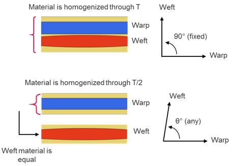

Woven
| Homogenization Scale | Comment |
| Homogenization of matrix, tows in warp and weft directions | Impractical to drape - any deviation from θ=90° is new
anisotropic material. Cannot distinguish between ply level fiber and matrix direction results. |
| Homogenization of matrix and tows in just one direction | Weave modeled as two uni plies with ½ T. Same material when θ changes. HyperMesh uses this methodology when importing woven plies from external composite data. |

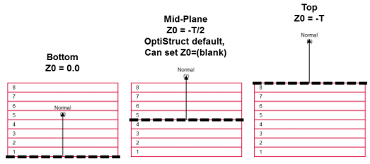

Offsets
Offsets determine the location of the laminate relative to the mesh.
