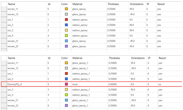

Ply Auto Rename
Ply Auto Rename changes ply names so that the assigned material, thickness and angle are appended.
From the menu bar, click .
Figure 3. Ply Names as Defined in the CAD System
Figure 4. Updated Ply Names

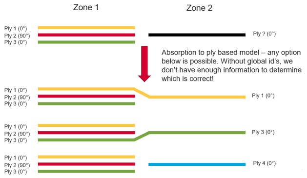

FE Absorb Plies
FE Absorb Plies generates a ply-based model from zone-based properties.
Figure 5.

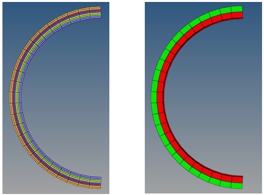

Shell To Solid Conversion
The Shell To Solid Conversion tool provides functionality to generate solid elements and material orientations from a ply based shell model.
