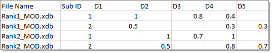

Load Combination File (LCF)
Use the load combination file to combine loadcases and create new loadcases (derived cases).
Derived case (D1) = L1 *SC1+L2*SC2+...
Figure 1. In this Example D4 (derived case) = LC1*0.4+LC2*0.3+LC3*1+LC4*0.8

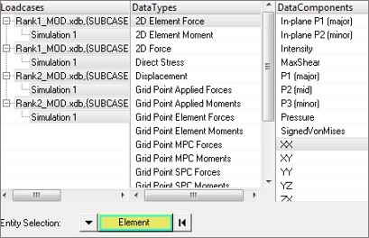

Prepare the Results for the Explorer Tool
This is done in the following sequence:

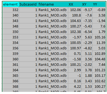

Default Loadcase Results
In this case the raw results exported to an Excel file are for the selected elements, selected loadcases and the results type.

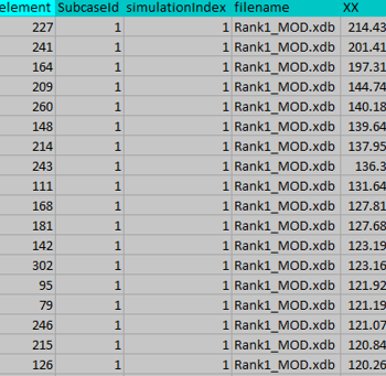

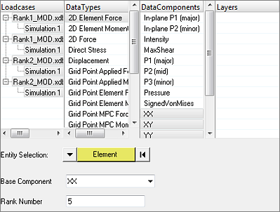

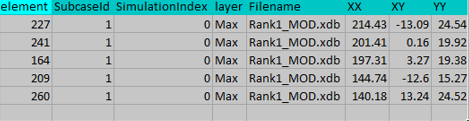

Ranking
The goal of this use case is to find the top N values (rank=N) of a specific results data type and report for which element and loadcase they occur.
Figure 4. Ranking of the Top Five Values for the Component XX

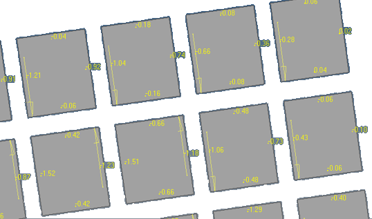

Bar End Load and Shear Plot

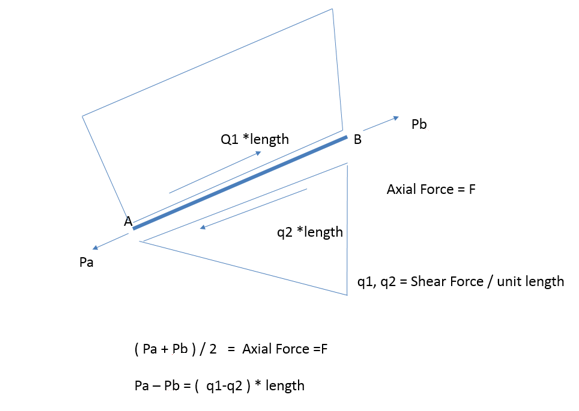

- Bar End Load
- In bar element the axial force at each end is increased or decreased due
to the shear forces acting along the side of the shell elements attached
to them. These end loads are used in certification calculations.
- Shear Plot
- Calculate the shear load acting along each edge of a shell element for rivet load calculation or bar end load calculations. This is output as force per unit length.
Figure 8. Output: Each Loadcase is Displayed in the Graphics Window for each Element
Figure 9. Shear Plot is Shown on Each Element Edge

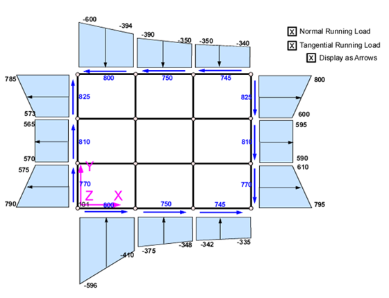

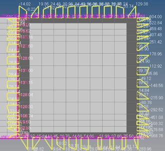

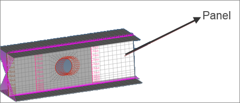

Panel Load
A panel is a group of shell elements bounded by beams, T section and free edges.
Figure 10.
Figure 11.
Figure 12.
