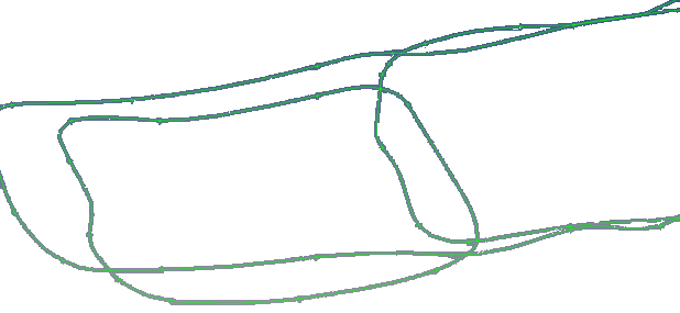

Figure 1. Result of Smoothing with Iterations = 0

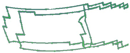

Figure 2. Result of Smoothing with Iterations = 20
