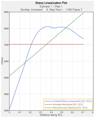

From the Plot portion of the tab, select from the following plot options:
Extracted and Linearized Values or Linearized Values.
- Extracted and Linearized: This will plot tensor component data of both extracted and linearized stress (average membrane and membrane+bending) tensors.
- Linearized: This will plot tensor component data of only the linearized stress (average membrane and membrane+bending) tensors.
Then select the stress components and invariants that will be plotted versus distance as an X-Y plot by activating/deactivating the appropriate check boxes.Stress linearization calculations will result in the generation of average membrane, bending, membrane + bending and peak stress tensors. This is in addition to the stress tensors that are extracted at each of the points along the line.For each component that is shown, the following will be plotted on the Y-axis with the distance of each point along the line on the X-axis:- The extracted stress component value at each point (Y-axis).
- The average membrane stress component.
- The membrane + bending stress component.
