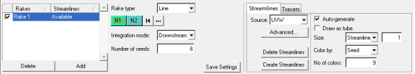

Use the Streamlines tool to generate streamlines using any available nodal or elemental vector field (typically a velocity field).
HyperView has a direct reader of EnSight files, thus allowing post-processing of typical CFD results from a large class of industry practices. The EnSight reader has been enhanced to support particle data (for example, modeling of dust particles in a flow) existent in a data set which can be animated; as well as transient data, including mesh deformation (for example, sliding mesh and ALE). The EnSight file type (*.encas, *.case) is available in the Files of type drop-down menu, located in the Load Model File or Load Results File selection dialog. In addition, Ensight files produced by SC/Tetra and other CFD solvers (for example, AcuSolve, Fluent, etc.) can also be loaded into HyperView by selecting the Auto option from the drop-down menu located in the Reader Options dialog. A separate SC/Tetra Ensight files option is also available for loading SC/Tetra files only (see the CFD Ensight Reader topic for additional information).
From the Create tools, select .
Figure 1. Streamlines Panel
