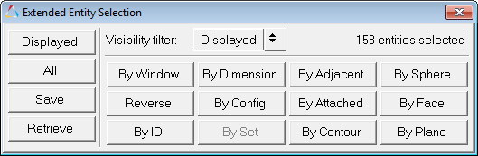

Extended Entity Selection Menu
The extended entity selection menu provides a number of entity selection options.

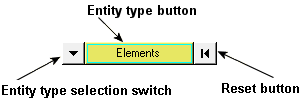

Figure 1. Input collector – elements selected
Figure 2. Extended entity selection menu for the Elements entity type
You can then select an option from the extended entity selection menu. The above image shows all the selection options available in HyperView. However, not all entity types offer all the selection options. Only valid selections for the current entity type are displayed on the menu. For instance, if you are using the Systems input collector, the By Config, By Dimension, By Sphere, and By Set (Group) entity selection options are not available.
HyperView is capable of entity binding changes between nodes, elements, and components - which provides you with easy selection. For example, when Nodes is specified in the input collector, the By ID option allows you to select either By Node ID, By Element ID, or By Component ID. Similarly when selecting nodes, the By Set option allows you to select a node set (group), element set (group), or component set (group). If you select an element set (group), the nodes connected to the elements defined in the set (group) will be selected.

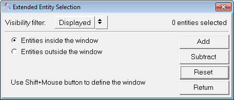

- By Window
- Select entities based on a user-defined multiple-sided polygon on the screen.
Figure 3. Extended Entity Selection -- By Window menu for the Elements entity typeUse Shift + left mouse button to define the window points. Select points in the modeling window to define a window enclosing the pick handles of the entities to select or exclude.- Select Entities inside the window to highlight the entities within the window.
- Select Entities outside the window to highlight entities outside of the window.

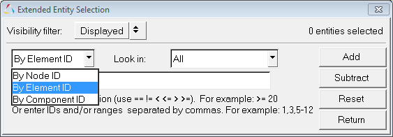

- By ID
- Select entities by entering an ID number.
Figure 4. Extended Entity Selection -- By ID menu for the Elements or Nodes entity typeMake a selection from the By ID drop-down menu (By Node ID, By Element ID, or By Component ID), and then enter a valid expression (listed below) and an ID in the text box.
- Displays entities equal to the ID entered
- Displays entities not equal to the ID entered
- Displays entities less than the ID entered
- Display entities less than or equal to the ID entered
- Displays entities greater than the ID entered
- Display entities greater than or equal to the ID entered

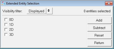

- By Dimension
- Select entities by dimension (0D, 1D, 2D, and 3D). You can select one or more of the
dimensions available.
Figure 5.Setting the input collector to Nodes allows you to select nodes attached to all elements with the selected dimension. HyperView performs the entity binding changes for proper selection.

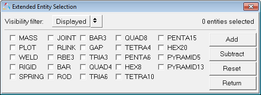

- By Config
- Select elements by configuration. You can select one or more of the various element
configurations available.
Figure 6.If Element configuration is selected, HyperView will apply the binding changes to find the nodes connected to the elements.

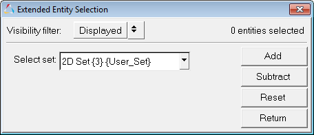

- By Set
- Select from a drop-down menu of created sets/groups.
Figure 7. - By Adjacent

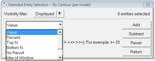

- By Contour
- Select entities by contour.
Figure 8.The following contour options are available:- Value
- Enter a contour value in the text box (see the Note below).
- Percent
- Enter the percentage of entities to select (0 to 100) in the text box (see the Note below).
- Top N
- Enter a positive decimal value for N, where N is the number of entities to be selected. For example, if you enter 50, the application displays the top 50 elements/nodes that have the highest contour value.
- Bottom N
- Enter a positive decimal value for N, where N is the number of entities to be selected. For example, if you enter 50, the application displays the bottom 50 elements/nodes that have the lowest contour value.
- No result
- All nodes or elements without any results are selected.
- Max of Window
- Displays the maximum contour value for the entities defined using the Quick Window Selection feature (Shift + left mouse button).
- Min of Window
- Displays the minimum contour value for the entities defined using the Quick Window Selection feature (Shift + left mouse button).

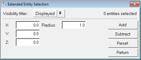

- By Sphere
- Allows you to select entities by entering location information for x, y, z and also
entering a user-defined radius.

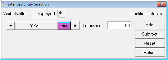

- By Plane
- Select nodes/elements that lie within a certain tolerance (in model units) of the
defined plane. This selection method uses a vector input collector (X Axis, Y Axis, Z
Axis, Vectors, N1N2N3, Normal to screen).
Figure 10.
