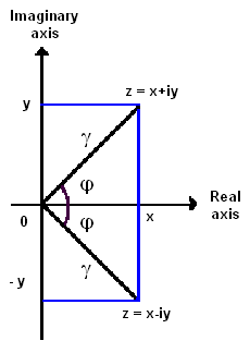

Results in some analysis types come as complex numbers.
z = x + iy
x
is the real part ofz
.y
is the imaginary part ofz
Complex number can also be written in the polar format:
x
.y
where
, is the magnitude of z.
and
is the phase of z.
Where ,

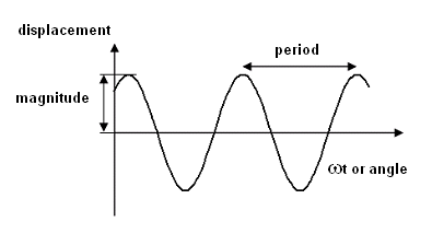

is the angular velocity and t is time. In HyperView, you can select the increment of ωt (called "angle") from the Animation Controls
panel.

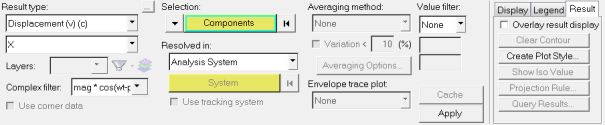

Complex Result in HyperView
Figure 1. Contour panel with complex results
In modal animation mode, there is selection to choose a complex filter.
- mag * cos (ωt- phase)
- the response with varying angle or ωt (in degree).
- mag
- magnitude (r) of the complex result
- phase
- phase
of the complex number
- real
- real part (x) of the complex number
- imaginary
- imaginary part (y) of the complex number
Other functionalities can be viewed in Contour panel.
