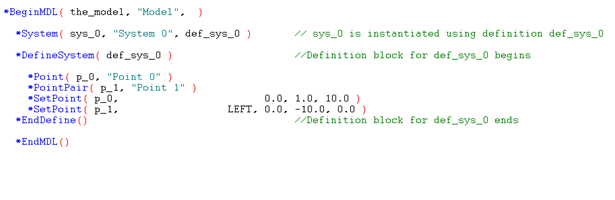

Container entities such as systems, assemblies, and analyses are referred to as definition based entities, along with others such as data sets and templates. These entities are created (called by instances) by an instantiation statement in the MDL that refers to a definition block (see an example below):
Figure 1. MDL statements for instantiating a system definition

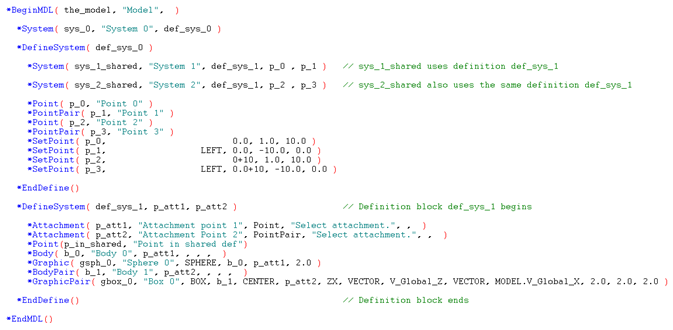

Accordingly, it is possible that multiple instances can be instantiated off of the same definition block. Such instances are referred to as shared instances or linked instances. Therefore, two or more systems instantiated by referring to the same definition block are said to be shared systems or linked systems. The sharing can only be established through authoring a model using the text editor in the MDL language. It is not possible currently to create shared instances using the HyperWorks graphical user interface. An example is show below:

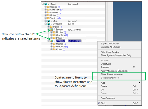

Improved support for shared instances has been provided in the HyperWorks graphical user interface:
- The Project Browser indicates the sharing between
instances with a separate hand icon appended to the standard icon of the entity.
This change is applicable to the following entities: systems, analysis (inline),
graphic systems, data sets, templates, command sets, and forms.
Figure 3. - The Project Browser right-click context menu provides
the following options (shown in the image above):
Show Shared Instances Allows you to view information related to shared instances. Separate Definition Allows you to stop sharing the definition. See the Browser Context-Sensitive Menu topic for additional information.
- You have the choice of retaining the linkage between shared instances as the individual instances get modified, or to break linkage.

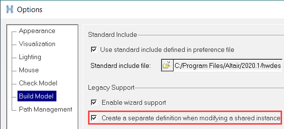

- A Create a separate definition when modifying a shared instance
option is available in the Options Dialog - Build Model (Tools > Options > Build Model) which allows you to control how shared instances should be
handled while modifying them.
Figure 4.By default, this option is turned on indicating that any modification to a shared instances will result in a separate definition. Turn this option off in the case where the sharing has to be retained and a change to one instance should be applied to other shared instances also.
