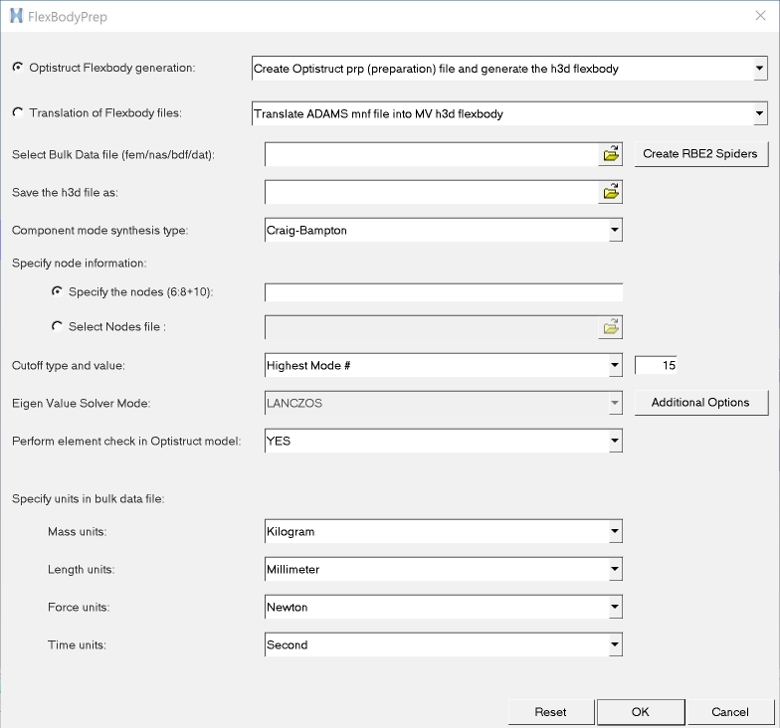

The FlexBody Prep wizard (or simply FlexPrep) allows you to create a flexible body H3D file using Optistruct, as well as translate an ADAMS MNF file or a mirrored H3D file. The FlexPrep also takes other types of input files, such as Nastran BDF.
From the Analyze ribbon, Tools tool set, click the FlexPrep icon to access the FlexBodyPrep wizard.
Figure 1. FlexBodyPrep wizard
From the FlexBodyPrep wizard, you can perform the following functions:

The dialog options change depending on the translation type you select.
Mass/Length/Force/Time Units | Specify the units either in the input FEM (while creating the flexbody) or in the output MTX file (while translating from flex H3D to Adams MTX). |
Clear | Clear your selections and reset the wizard. |
OK | After making your selections, click OK to have the wizard create your
file. OK assembles your wizard selections into set of command line arguments for flexprep and invokes flexprep. To run flexprep from command line:
