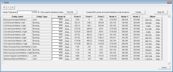

Click Nodes on the Properties tab.
The Nodes dialog is displayed.
Figure 1.For each marker, a node needs to be specified that will act as an interface between the connecting entities and the deformable body.
Find the interface nodes in the deformable body.
- Click Find All and MotionView will find the interface nodes which are closest to each of the listed markers of the entities connecting the deformable body.
- Click Find and look for interface nodes for each marker individually.
Note: The flexbody H3D file for the deformable body contains two types of nodes: interface nodes and non-interface nodes. The interface nodes are those which have been selected to be the interface nodes while creating the flexbody file. These are the nodes which connect the flexbody to the rest of the model. The Only search interface nodes check box specifies that only the interface nodes are to be searched. This ensures that the nodes are found quickly. -
Review the interface nodes that are found.
If the Offset column, a measure of the difference in the point and the node coordinates, shows the offset as 0.000 or 0.001 (this generally happens due to differences in rounding off significant digits), it means that the interface nodes coordinates and the marker origin coordinates are at the same location.
If the offset value is significantly large, a review of the connecting entities, deformable body position, and node coordinate position is recommended. A large offset value could cause difficulties for the solver or may lead to erroneous results.
Click the Align button at the end
of each row to align the point coordinate with that of the node.
CAUTION:This option should be used with significant caution, as it causes the point referenced by the connecting entities to change its position and might affect other entity definitions.
Click Create (located in the
top-right corner of the dialog) to create points at the interface node
locations.
This is particularly useful when you need to create points at the interface node location for adding joints or other elements that interact with the deformable body.
- Click Close to exit the dialog once all operations are completed.
