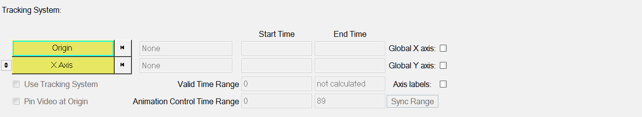

Marker Tracking System
Establishes a dynamic local coordinate system based on one or two tracing markers.
When a marker is traced, the coordinates of the marker can be reported with respect to the tracking system defined in this panel. This enables you to calculate only the dynamics of marker movement by removing overall motion of the video.
The user-defined coordinate system is displayed in the graphics area with arrows of the selected colors to represent the X and Y axes.
- Collectors
- Use the Origin collector to select the marker to be used as the origin.
- Start Time
- End Time
- Two start and end time fields exist:
- The start time and end time for the origin marker, showing the start and end time steps in the video during which the marker is valid.
- The start time and end time for the X axis or Y axis marker, showing the start and end time steps in the video during which the marker is valid.
- Valid Time Range
- The time range during which the defined tracking system is valid. Since both markers must be valid in order for the system to be valid at a given time, the start time will always be the latter of the selected markers’ start times, and the end time will always be the earlier of the selected markers’ end times.
- Animation Control Time Range
- The time range shown by the start and end times in the Animation Controls panel, and can be synced to the valid time range using Sync Range.
- Sync Range
- Syncs the Animation Controls time range to the tracking system’s valid time range. Click Sync Range to update the start time and end time edit fields for the Animation Controls Time Range and also to update the start and end times in the Animation Controls panel.
- Use tracking system
- This option is disabled by default, and is enabled and automatically selected once a tracking system has been defined. When off, marker tracing data is reported with the origin assumed to be in the lower left corner of the video.
- Pin video at origin
- This option will cause the origin to remain fixed in place on the screen while animating, during the time frame when the origin is a valid tracing marker.
- Global X axis
- Click the color selector to select the x-axis color.
- Global Y axis
- Click the color selector to select the y-axis color.
- Axis Labels
- Click the color selector to select the axis labels’ colors.
