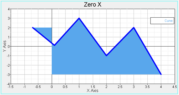

- Zero X
- Shades from the Y axis (x = 0) to the curve.

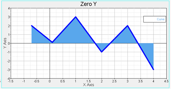

- Zero Y
- Shades from the X axis (y = 0) to the curve.

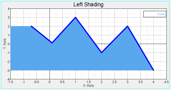

- Left
- Projects the endpoints of the curve onto the left hand side of the plot, and shades the curve from the left, including any portions above/below horizontal lines through the curve’s endpoints. The horizontal lines projecting the endpoints onto the left hand side of the plot are not drawn.

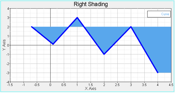

- Right
- Projects the endpoints of the curve onto the right hand side of the plot, and shades the curve from the right, including any portions above/below horizontal lines through the curve’s endpoints. The horizontal lines projecting the endpoints onto the right hand side of the plot are not drawn.

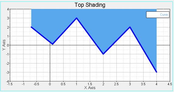

- Top
- Shades everything in the plot above the curve.

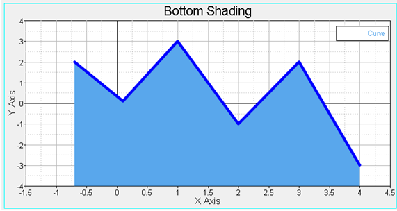

- Bottom
- Shades everything in the plot below the curve.

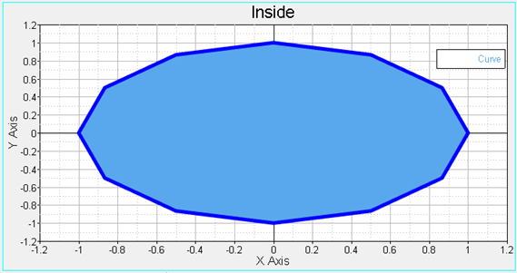

- Inside
- Shades within the polygon created by the curve.

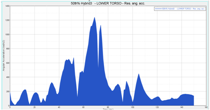

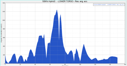

Figure 1. Curve with the Reference property turned off (“Zero Y” shading)
Figure 2. Curve with the Reference property turned on (“Zero Y” shading).
Figure 3. Zero X Shading
Figure 4. Zero Y Shading
Figure 5. Left Shading
Figure 6. Right Shading
Figure 7. Top Shading
Figure 8. Bottom Shading
Figure 9. Inside Shading
