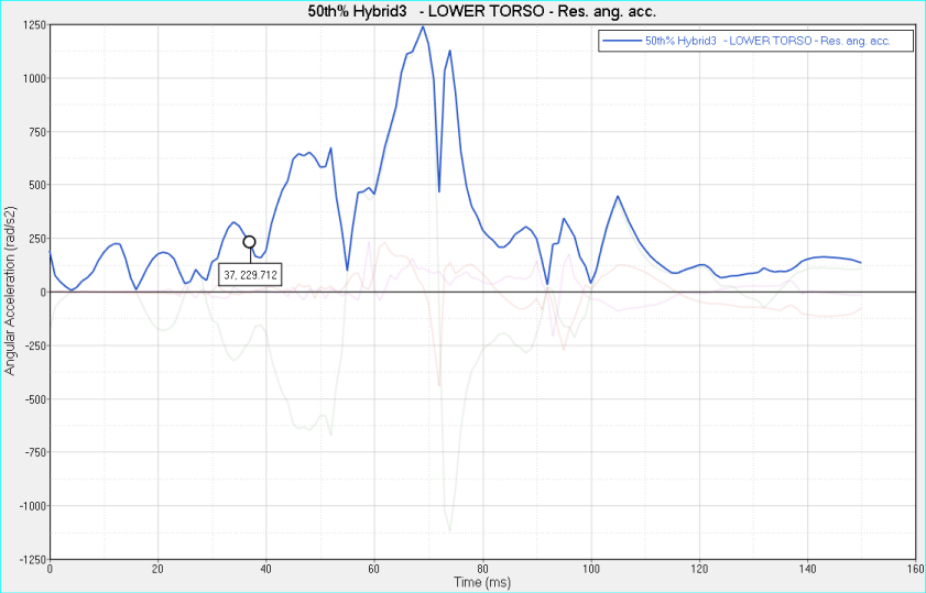

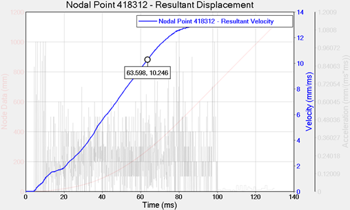

selected.When a curve is clicked in Inspect mode, the following behavior is displayed:
- The curve reverts back to its specified curve color, and all other curves in the plot fade out.
- Circular markers appear at the curve's data points. The other curves on the plot are hidden, or fade into the background.
- The legend only displays the selected curve and only the axes associated with the curve is displayed.
- When you hover the mouse pointer over a data point on a curve, the data point coordinates are displayed in a temporary note.

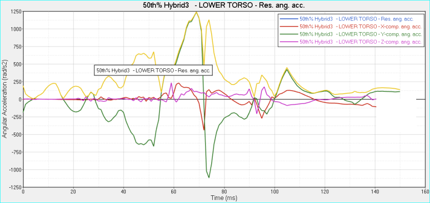

- When you move the mouse pointer over a non-highlighted curve, the curve is pre-highlighted in its original color, instead of the standard gold pre-highlighting color.

Figure 1. Plot with Inspect mode enabled
Figure 2. Plot with Inspect mode enabled, with a curve selected.Note: Notice the visible data points, temporary pop-up note, reduced legend size, and faded out curves in the background. - Pre-highlighting of Plot Attributes

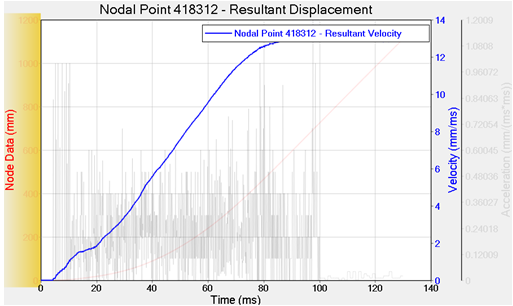

- Plot attributes such as curves, axes, legends, and headers/footers can be
pre-highlighted by passing the mouse pointer over the entity.
Figure 3. A pre-highlighted curve, with the curve name displayed in a temporary note.
Figure 4. A pre-highlighted axis.

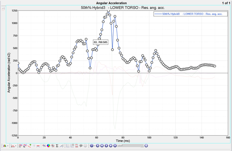

- Circular markers are displayed at the curve’s data points when a curve is selected while in Inspect mode. If data points are so close together that the markers overlap by a distance more than 50% of the radius of the markers, only the circular marker closest to the mouse pointer the will be shown.
