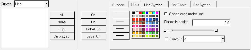

Curve Style
Define curve attributes.
Curve List
The Curve List displays the names of the curves in the current window.
From the drop-down menu, you can select the curve type: Line, Surface, Waterfall, Query Lines, or Bar Chart. This displays only curves of that type in the Curves list.

Curve and Label Display
Curves and legends can be displayed or hidden in the graphics window.
- On/Off
- The On/Off buttons allow you to turn the selected curves on or off in the display.
- Label On/Label Off
- The Label On/Off buttons allow you to turn curve legends on or off in the display.

Line Attributes
Line thickness can be assigned to a curve. The line weight for each curve is displayed in the legend. Click on a line weight to change the thickness of the currently selected curves.
Any of the 64 colors can be assigned to a curve. Select a color from the color palette to change the color of the selected curves.
- Shade area under line
- Fills in the area under the curve line with a solid color.
- Shade intensity
- If you select Shade area under line, you can determine the shade intensity by either entering a value directly or using the slider bar.
- Contour
- Click Contour and define the contour values by entering a math expression to define contour values. You can use the default X, Y, Z selections or use your own math expression.
