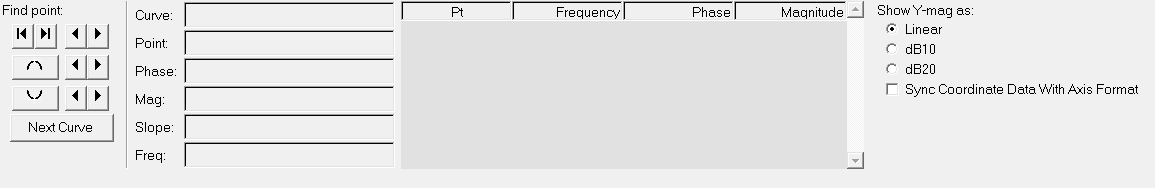

Retrieve individual point data on any curve in the active window. When a point is selected, the point data is displayed on the panel.
Figure 1. Values panel
There are three ways to retrieve point data from a curve. A point can be picked from a curve, located using the Find Point controls, or selected from the point list.

Point List
The point list displays the phase and magnitude data points for the selected curve. The point number, the phase-value, and the mag-value for each point are displayed in the list. Use the scroll bars to view the entire list. Click on a point in the list to display the point data. For vector plots, frequency is included in the value table.
