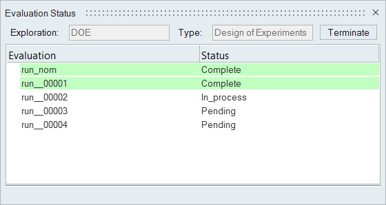

Click Run.
The Evaluation Status dialog opens. Here, you can track the progress of each run.
Figure 2.HyperWorks creates run files in the approaches directory.
